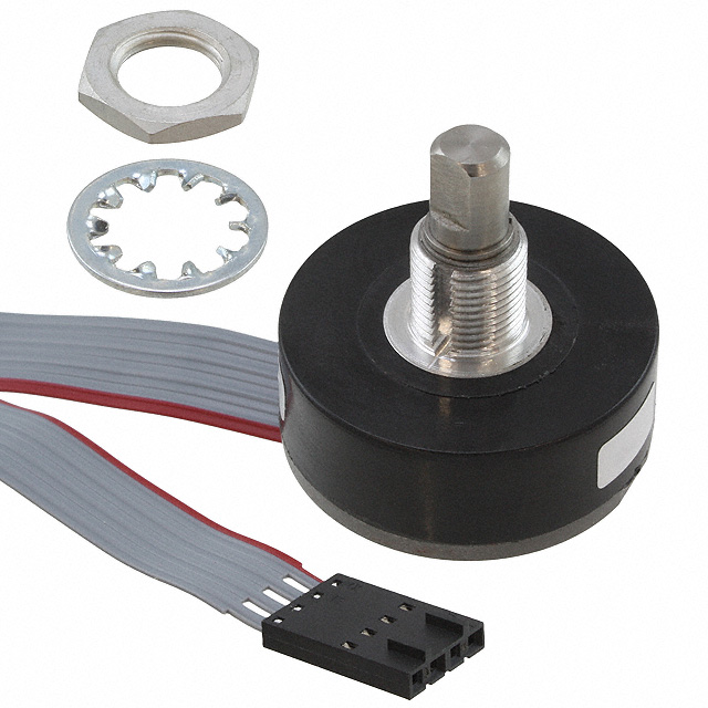

We like the Grayhill 61K128-050 available from Digi-Key. Easy to mount. Other resolutions available.
