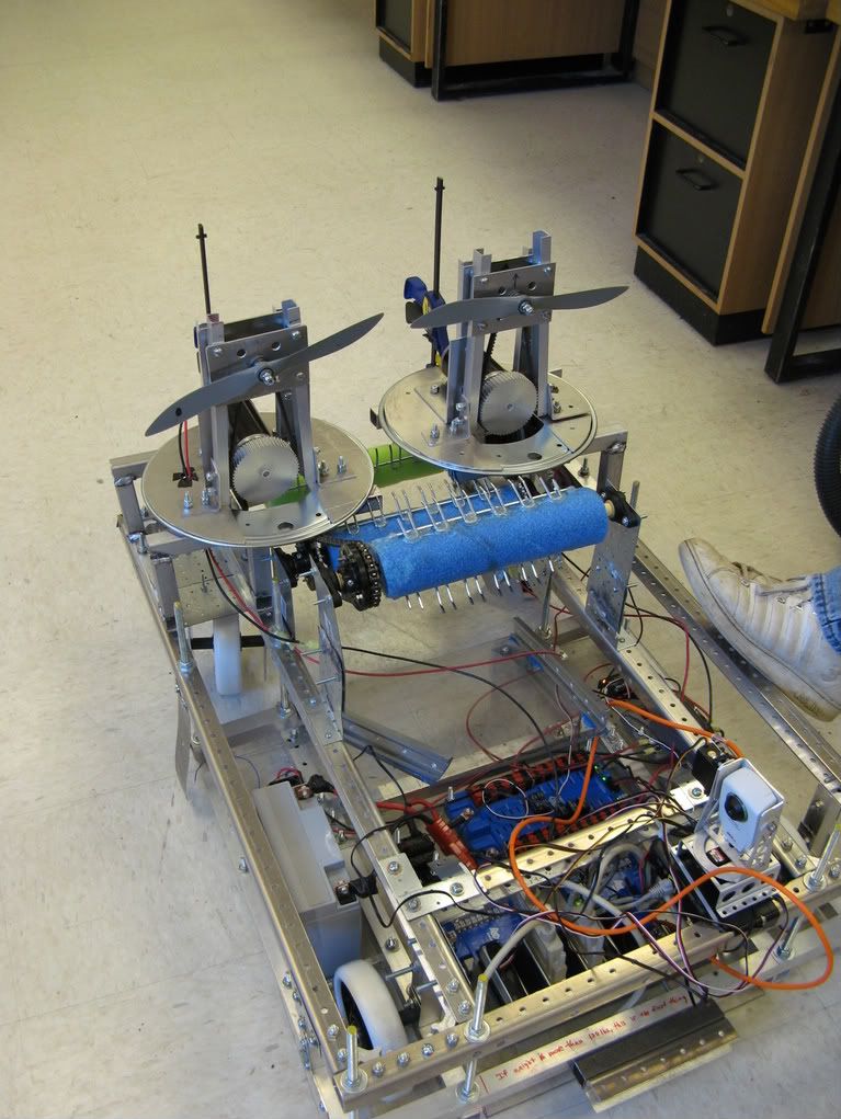

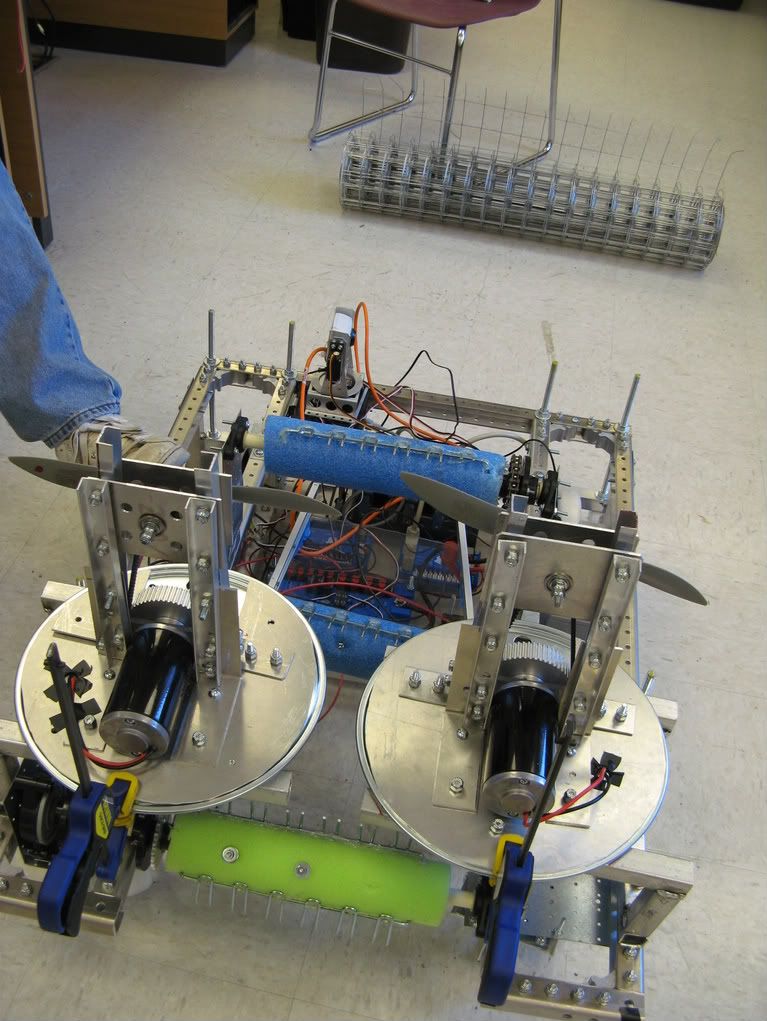

For those who are skeptical about propellers - Team 2526
The props both spin at about 7000 rpm, but they haven't been properly calibrated yet, so we may get quite a bit more power out of them.
Videos:
http://www.youtube.com/watch?v=mlUPGUfgrHo#
http://www.youtube.com/watch?v=crKvPEwvf-U

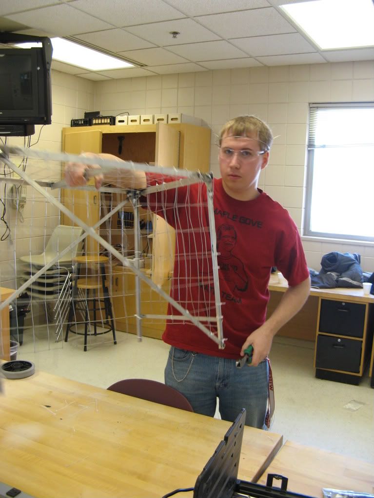

And for those safety nazis -- why yes we do have a safety cage for it

What type of props are those? They look like 9"x something. Are they balanced? If not, I can tell you how to balance a prop.
Also, I'm not quite sure that that cage is going to be enough. I'd put another layer on on top or underneath so that the area of each open area is divided into four areas--if the props do explode, I'm pretty sure they could get through the pictured version. Reducing the open area will also reduce the risks.

Wow that totally is a unique and different propulsion system! I cant wait to see that in actual competition!
I would tend to agree with Eric though, I'd add some more protection to that cage. The cage will protect from reaching hands, but if those props were to ever break, (and going 7000 rpm, they very well might) you dont want blades going flying... I'm not a safety Nazi, I just like being safe.
Overall though, Awesome!

safety cage we are going to use is designed to keep balls outs rather than keeping blade shrapnel in.

What are the pegs on your rollers? What's the diameter of them? If they are too small, you might have inspection problems.
The inspectors will be looking for both. One piece of prop shrapnel gets through, and <S01> is probably going to be called. Then you have to remove both.
Let's say those are 9" blades going at 7000 RPM. That's C=pi*d=pi*9=28.26" per revolution. That's about a 2' circumference (rounded down to emphasize the need for protection here). So, the tips of that prop are traveling at 7000RPM=116.7RPS over a 2' circle. That's a tangential speed of 233.3 feet per second--or about 4 FRC fields in one second. If a tip breaks off at that speed, you WILL get a safety violation if it leaves the robot! And, if I were the head ref, I'd make you either remove the props or add protection to the cage. Play it safe and add material now.
Edit: I just saw this: http://www.chiefdelphi.com/forums/sh...049#post812049
I would consider this, or something similar, much safer than your current setup.

Nice work, looks like you put some thought into the design. Good use of model airplane props.
Are you worried that having the props mounted in a biased configuration (not dead-center on the robot) will tend to make the robot turn or move awkwardly? I assume you offset them to make room for a ball-handling system. Will the airflow pass through the ball system or will you reverse the rotation to reverse the direction of the robot?
On a separate note, have you checked the metal hardware on your collector to make sure it's not going to rip up the balls? Looks iffy to me.

The propellers are perfectly safe as long as they don't exceed their maximum rpm, the rate at which we are spinning them is no where near their maximum rpm (the maximum is about 13k rpm). Having them spontaneously exploding is not a huge concern to us, having balls getting in the way of the props is a much bigger concern. (oh and its 12.25 in in diameter btw ;D)

Yeah, that's why we have a 3.5 multiplier on our props. So the 2.5 k rpms you get on a CIM motor at peak power output you don't have nearly enough pushing power. Our props are actually push them at about a walking pace.
See, ideally you reach 88% - 94% the speed of sound on the tips of your props in order to get maximum power.

Who is dumb enough to stick their fingers in there?? Plus the props are far enough inside the cage that even if you can get your fingers in, they wouldn't touch the props.
PLUS who's running around the field trying to catch a robot by sticking their fingers into the cage with spinning blades???

Well, our blade/s pull too much power to gear it up any. We start tripping a 40A breaker at a 1:2 ratio. The size of our prop combined with the really high pitch, and the fact that the blade is cut to give a lot of thrust in one direction.. gave us a pretty good acceleration to around the speed you're describing at 3/4 ratio.
Of course we're going for different things. You have them for turning and maneuvering plus a good amount of power. And we're going for sheer power, mainly for getting across in a straight line fast, pinning, and then dumping.
