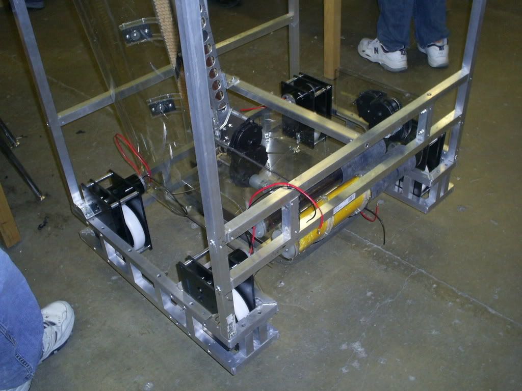

Silly thought: Imagine someone taking these modules, stripping off the swervy bits, and using it as an ultra-compact drive module in some other application. It probably wouldn't replace that 6WD setup most of us have sitting around for most strategies of play, but I bet we've all wanted the extra ground-level real estate at some point or another.
  #39   Spotlight this post!
Unread 13-06-2009, 23:57
Join Date: Feb 2007
Posts: 7,003
Re: pic: Team 221 LLC. - Wild Swerve Module
We actually did something similar to what I think you're talking about. I shall picture hunt....
This should remain a public link.
http://www.facebook.com/photo.php?pi...0&id=645471640
Each of those 4 drive modules is just bolted on in about a minute each. You could potentially raise and lower the modules depending on how you design it. Am I on the same page here?
