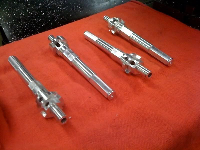

Re: West coast drive (6wheel) question
we make These... they are combo super shifter shaft, wheel, and we made our own dog for shifting.... They work really well, if you have 4th axis mill, or an indexer...
I have made these a few times, it can be a pain but its worth it!!!

Very nice work but we only have a 2 axis(CNC controled) mill. The third axix is manual.
