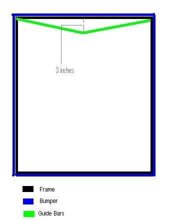

Is this legal?
http://i254.photobucket.com/albums/h...g?t=1263100442
Is this legal?
It does not break any bumper rules because there is a frame supporting all bumpers with no gaps. Also, the ball only extends a max of 3 inches into the frame.

Re: Is this legal?
Yes i believe that is legal

Re: Is this legal?
I don't see any rules violations.

Re: Is this legal?
I might as well ask this here instead of starting another thread about it. So would this be legal?
http://i55.photobucket.com/albums/g1...11/q109346.png

Re: Is this legal?
Where are the bumpers?
Assuming the bumpers are on the outside of the rectangle, then yes, provided that the extensions don't go beyond the bumper perimeter and drop back in within 2 seconds after deploying (<G30>).

Re: Is this legal?
According to <R16> this is illegal. You could not push the robot up against a wall and have it be flat on the frame's face.

Re: Is this legal?
Ok so you could do that but you would have to pull the mechanism back in after 2 seconds. I'm starting to see this as possible, but it'll probably be a waste of time.

Re: Is this legal?
Along with the 2 seconds, it also cannot extend the bumper perimeter (in which your's may or may not be <3 inches)

Re: Is this legal?
I thought the frame was the black line.

Re: Is this legal?
For the clarification on this ruling refer to the robot section of the manual, specifically <R19> and the image that follows this rule.
This pretty much answers all questions that teams may have on "possession".
