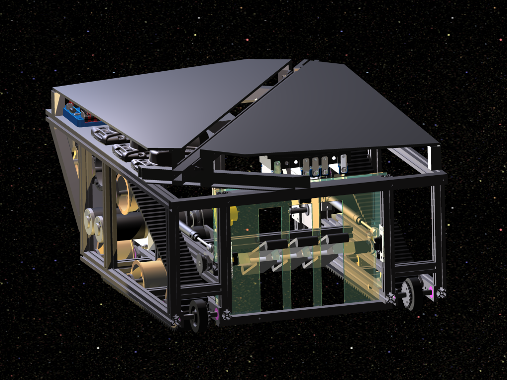

Here is one I made just now that does not include the bumpers. It definitely gives a better view of the internals

Just a small update on this baby: We will be lowering the roof to go under the tunnels now. Our "over the bump" approach failed with a resounding crash (literally). Our entire team had an epiphinay, that our robot was only 18 inches tall, and only a little more shaving off could put it under the tunnel. It also solves our weight deficit of 14 lbs, because all of our bump-traversing gear can now be taken off!

One thing you might have missed in those shots: on the edge of the frame around the kicker system there are 3 IR sensors. We are using those to detect how centered a ball is in our kicking system and displaying that on our dashboard. Hopefully combined with the camera that will give us some good aim on where the balls are going
