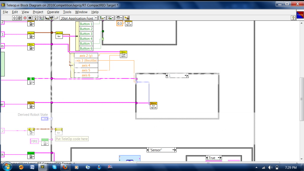

XBOX Controller Triggers is an axis but which one?
I have a MADCATZ Xbox 360 gaming controller, and according to the classmate the two back triggers are another axis. In Labview what axis is the axis 3(Throttle), or axis 6? i think it registers as the Z- axis and the RZ- (Z Rotational).

If you take the axis (or button for the matter) cluster coming out from the Get (or Get Axis/Button) VI, you can create a indicator and see what buttons/axis are what number in the code.

Tanner is right, but if he wasn't clear enough, this is how we did it:
-In your teleop VI, go to the block diagram and wire in two "Unbundle by Name" blocks (one for the axes and one for the buttons).
-Drag the bottom handle of the Unbundle blocks so every button and axis can be read.
-Go to your teleop VI front panel, and drop in one Numeric Indicator for each axis, and one LED for each button. Label them Axis1, Axis2, Button1, etc.
- On the block diagram, wire each button and axis to the corresponding indicator.
- Make a drawing of the controller.
- Deploy your code with the Play button, press each button and axes. Make a note of which indicator does what when you operate the controller. Use this to label your drawing.
- Once your drawing is fully labeled, you can start hooking up the axes and buttons to what you want them to control.
I know this is a pain, but this is how we did it. I have our drawing so I can't tell you which is which, but doing this process only takes 15 minutes or so. good luck.

It its axis 3

It is axis number 3, and it defaults to value of 0.0 and goes negative when right trigger is down and goes positive when left trigger is down.

Go to control panel --> game controllers --> properties. It shows up what button and axis is what when you press it. We have everything except the rumble. There's some threads, I believe in WindRiver, for using rumble, but does any one know how to do it in Labview? I would love to be able to have it rumble when our robot senses a ball.+

Just another quick Question. when I wired axis 3 into a True False Selector the true and False changed to 1 and 0 which i put my true code in 1, and my false code in 0. see attached pictures tell me if im doing this right. If the button is true then set the motor speed to the percentage of the button press, for variable control. If the button i...s false, then I made another true/false case for the sensor. In the false case, I set the motor speed to 0.1. In the true case, I set the motor speed to 0.
This way, when the button is NOT being hit, it looks for the sensor, and it spins it around REALLY SLOWLY until the sensor is tripped, and then it stops there.
I would recommend that you delete the wire from axis 3 and change your case structure back to TRUE and FALSE. Test axis three against "> 0.5" and if it's greater than 0.5, it will tigger the TRUE case, and if it's less than 0.5 it will trigger FALSE.
The problem with using the 0 and 1 cases is that it is possible that you cannot get to the 1 case if your XBox controller is out of calibration. If you use the 0.5 compare, you will be covered.
