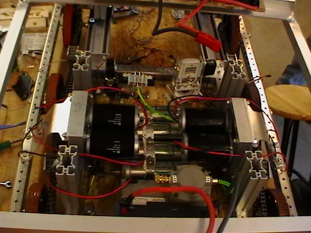

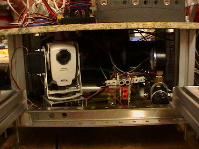

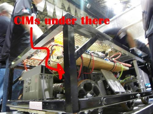

Re: Does motor temp affect performance?
Originally Posted by Ether View Post
It would be most interesting if teams experiencing hot CIM motors could provide some information about their robot design.
In the case of CIMs used for driving, that data might include ratio of gearbox, sprocket teeth count if using chains, how many CIMs (2 or 4 or ?), and wheel diameter and type of wheel.
- 6WD powered by 4CIMs through AM Toughboxes
- 6" Plaction wheels with roughtop tread
- roughly 18:1 gear ratio from CIM to wheel
however, we have a plywood tray holding our pneumatics, roughly at the base of the toughboxes, and a plywood electronics board practically sitting on top of it. No way to avoid it, as we're a tunnel bot.
Pictures here:
http://i298.photobucket.com/albums/m...e399f66d76.jpg
http://i298.photobucket.com/albums/m...5f2f2a56_o.jpg
http://i298.photobucket.com/albums/m...cfa3da23_o.jpg
-Rookie All Star Award [WAT Regional 2010]
Electrical/Control systems, Mechanical and Pneumatics teams, Human player
Hey Craig,
All six wheels on the ground? You have trouble turning quickly?
High friction wheels on carpet in turns causes high (and I mean very high) currents in CIM motors. Assume that the CIMs are going into stall every time you turn. I bet it would not be unusual for the CIMs to be running at 100 amps in turns, each. 100 amps means about 1200 watts per motor, all things being equal. Yes that is like four 1000 watt light bulbs in your robot making heat. The fix is changing the height of the center wheel, change some of the wheels to omnis or a combination of the two.
Al
Originally Posted by Al Skierkiewicz View Post
Hey Craig,
No, we have a dropped-middle wheel design
Craig,
You have to be more specific. How much is it dropped? How many wheels are actually touching the carpet, how many in turns? How heavy is your robot? What is the final ratio? etc.
