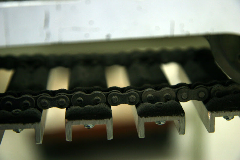

This year our Breakaway robot used a tank tread drive system. In order to save money, we designed it to use triple-wide drive chain run on two sprockets, rather than buying belts from Brecoflex. I think the chain was available through some surplus store; I don't know where we bought it. This worked out well for us since the chain was wide enough that we could use it as a track and it never slipped in competition. To make it legal, we attached small pieces of hose using bolts, as you can see in this picture.

on this year's winning NASA Lunar excavation robot, there were these tracks.
Thy consisted of aluminum C-stock fastened to chain that had special links that allowed things to be attached to them without modifying the sprockets. you can find them here: http://www.mcmaster.com/#roller-chain/=6s0umt Scroll down to the bottom and click on accessories. Unfortunately, they're only available for 35 pitch chain.
EDIT: Here's a pic of the link.
