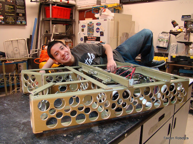

I really like the design, are you worried about multiple balls clogging your design?
Very nice job, good swiss cheese holes ---> Good Call!

Re: pic: View of our Harvester 842
Originally Posted by 5n1p3r View Post
I love the swiss cheese design on the frame, thats allot of weight u took off.
O yes, our frame was 24 pounds and when we where done with it all it was 14.
From this -
To This -
