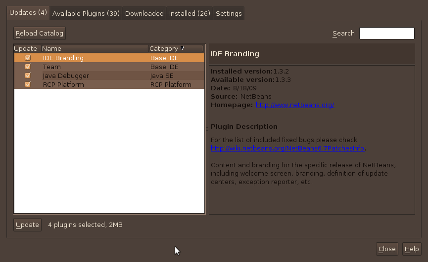

From the install guide:
NetBeans IDE version 6.7 or later (there may be issues running NetBeans V7, please install V6.9.1 until we’ve had a
chance to review this).
I checked our notes, we had trouble with 6.7.1 and 7.1.
