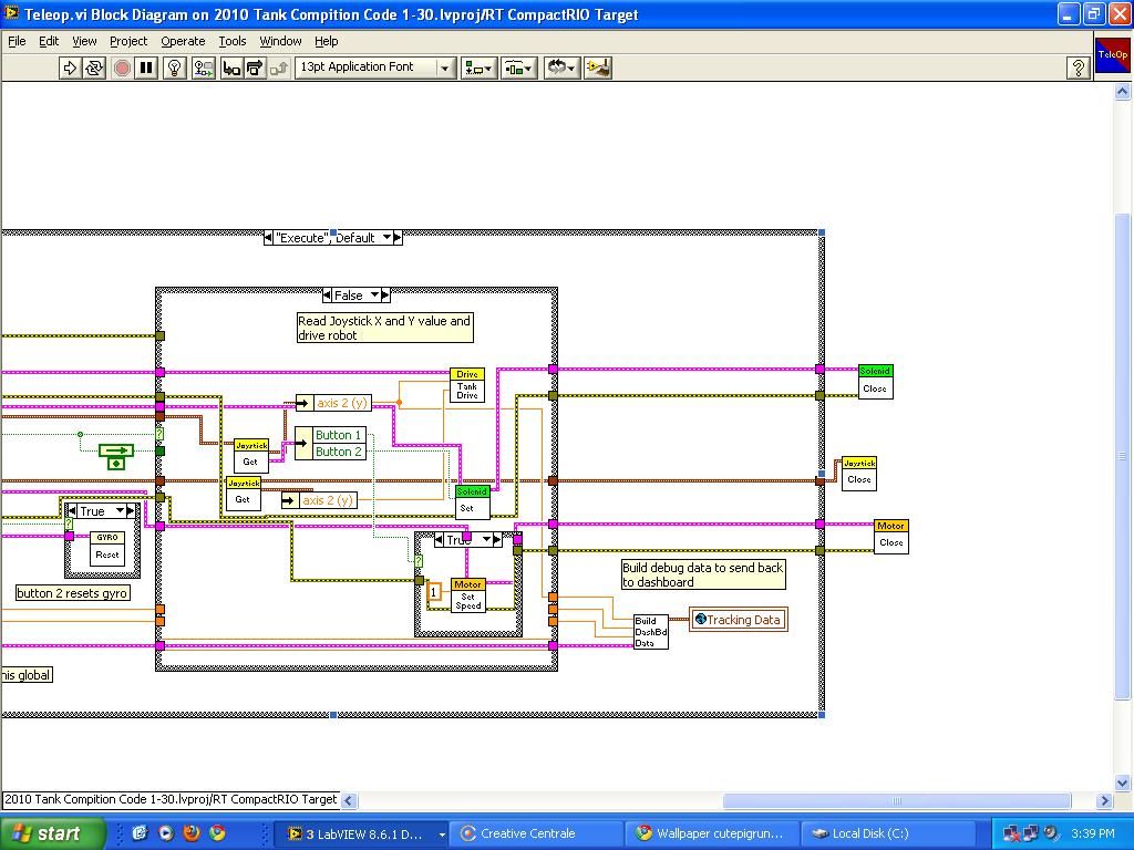

I want to use a physical switch to act how a boolean control does. Specifically I need the ability to use "latch when released", activating a case structure when the switch goes from True to False. I have no idea where to begin with doing this, but I've opened the digital input, set the channel it runs on, set it under a variable name, and gotten its true-false value. Where do I work from there?

The way I do it is to use a global variable.
I Use a case structure that is asking for the boolean and every time it turns true the value of the boolean is inverted.
Now in the picture I have it in teleoperated which causes some problems because you can't instantly press and release the button. So it cycles through true and false very quickly and I recommend some way of knowing the value.
Follow the Button Toggle Action example HERE

I don't think a toggle button will solve my issue. That would save the state until I pressed it again, which is most certainly not what I want.
Pretty much, in waveform description, I want the case structure to activate when the digital wave goes from 1 to 0.
I also can't use what that picture shows, since the variable will keep changing every moment the switch is pressed.

Okay I see what you want now. You want the action to only change when it goes from 1 to 0 and not when it goes from 0 to 1.

Okay so I may have found what I need, can't test it at the moment but http://team358.org/files/programming...tonRelease.jpg that node + less than system should work fine. genius design

That's exactly what you want. I've made teeny little SubVIs that just take a boolean input and do the feedback node/comparison step, calling them "RisingEdge" and "FallingEdge". Their icons are very small.
