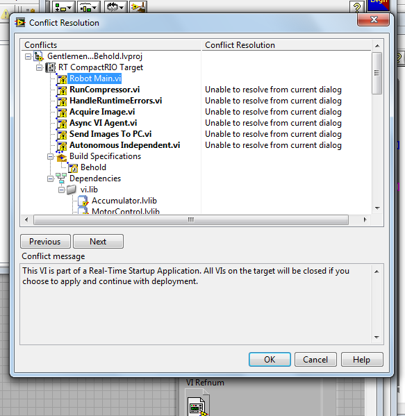

Now I get this ->

Re: How to use tasks
Ah, try this instead.
Code:
static void TestTaskFunction(void)
    std::cout<<"task has been started"<<endl;
4174robot::4174robot()
    task1 = new Task("testtask", (FUNCPTR) TestTaskFunction);
Alright that works... I don't get it (FUNCPTR vs VOIDFUNCPTR), but it works.
Then I was like, why am I getting no output on my console. Then I remembered that the windriver console only works for the current task. (or something like that)
No, not true. we printed debug output from a different task. I don't know if the picture showed the whole code but it doesn't seem to have the task1->Start() call. I don't think the task get started automatically when created. You need to explicitly start it.
