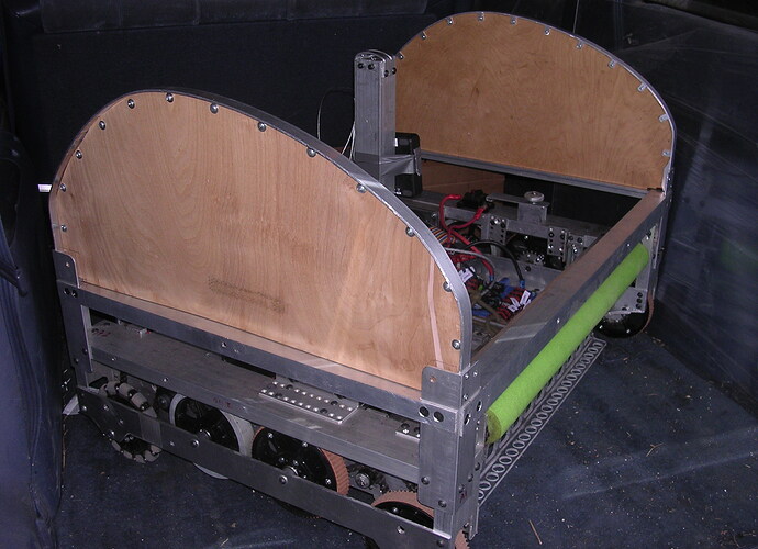

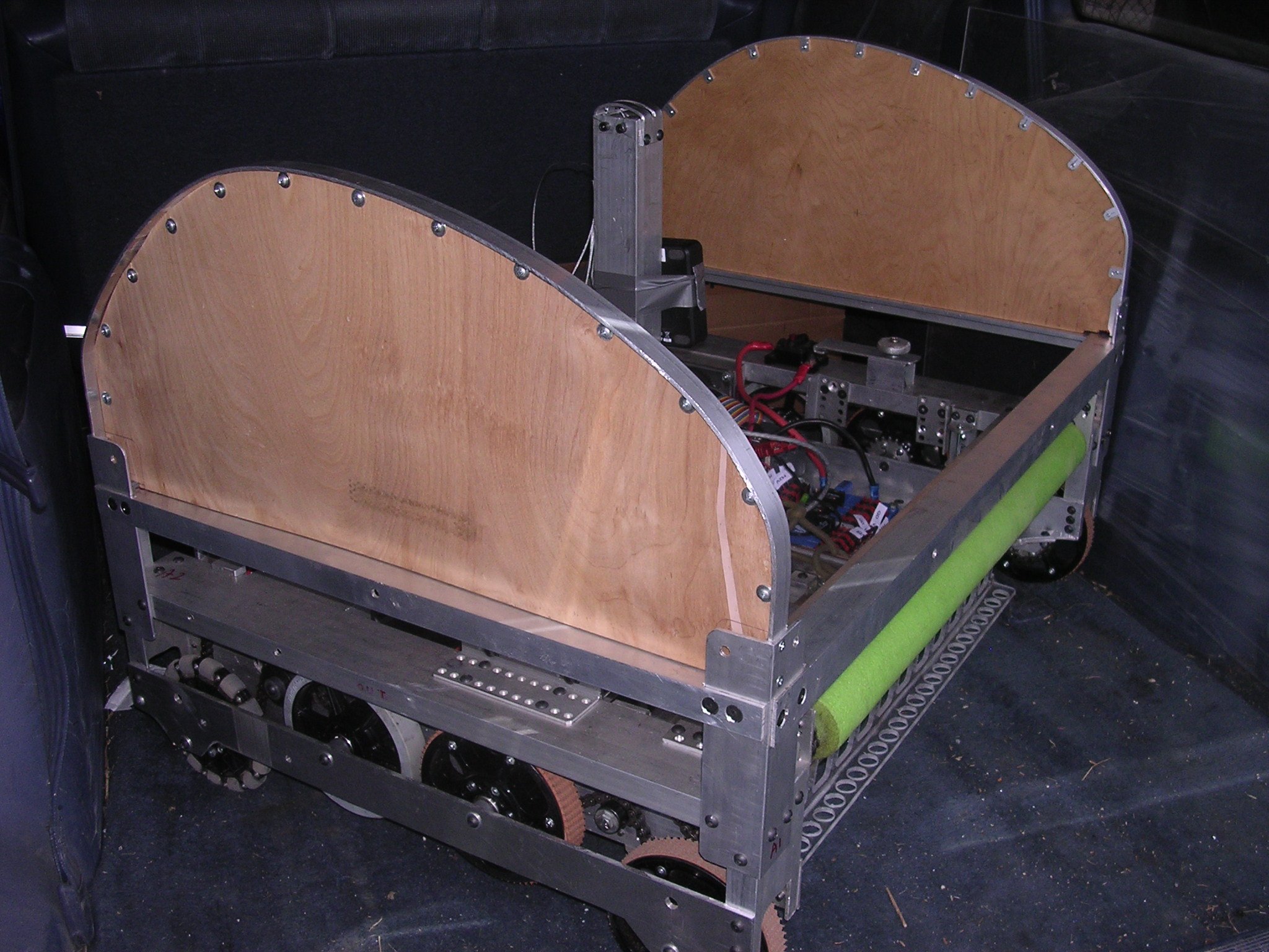

3% stretch is working ok for us. We are using 1-1/2" ABS (about 2" outside diameter) rollers that are about a foot long. We're using ball bearings in end caps to support the rollers. We don't have any grooves in them, instead we have a simply plywood "comb" above the lower roller to keep the cords in place.
Pictures of your robot would help us help you figure out what's wrong... |

How about a picture of the "comb" Does it help rerail derailed cords?
Thanks Bruce |
#7
Re: Polycord Slippage
Here's our comb. It doesn't allow the cords to derail, they're pretty well contained. But you have to experiment to figure out if it will work for you, it will not prevent the cords getting tangled up if for example the balls are trying real hard to push the cords sideways.
