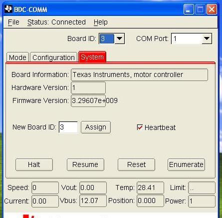

6: Reimaged cRio
7: Reset/recalibrated jaguars
