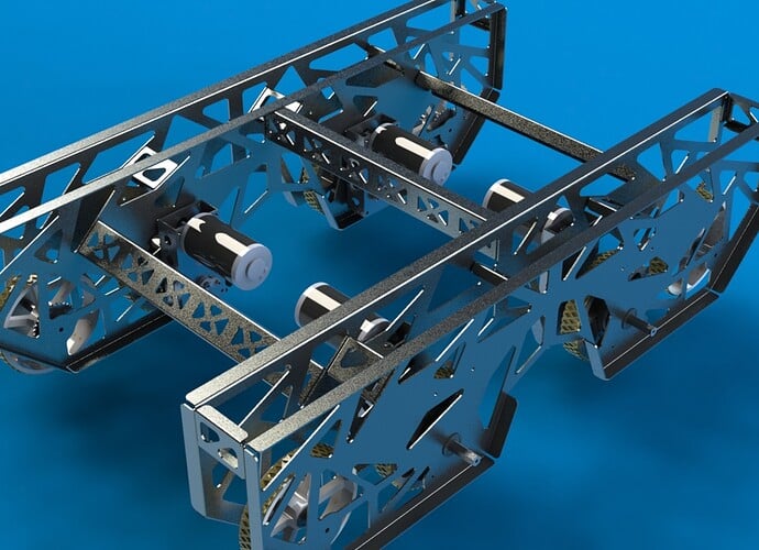

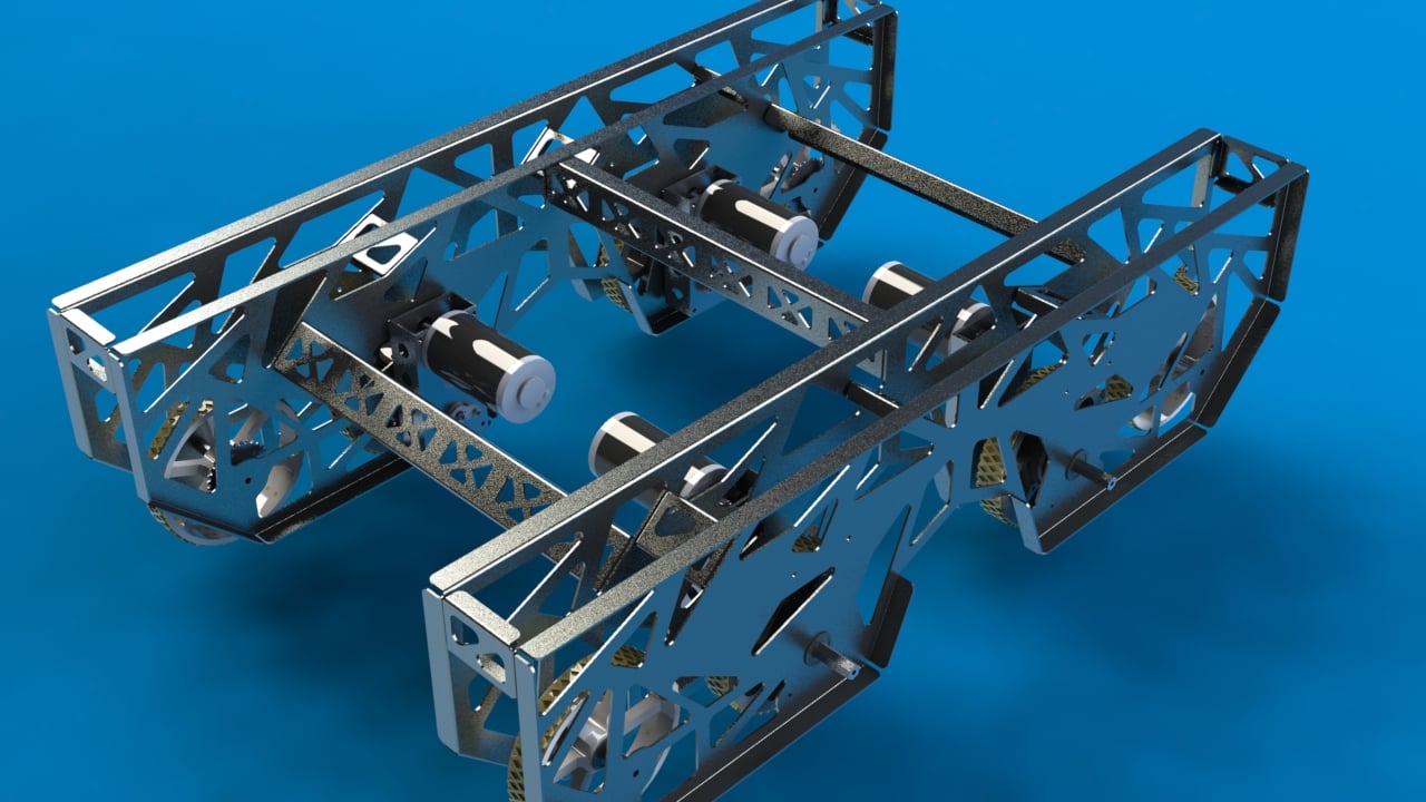

I think your hands down favorite/best material to construct a robot out of is waterjetted and bent aluminum sheet metal, since you can design it to the exact requirements you need, given you an optimum strength to weight ratio.
Lacking the fabrication support necessary for the above, 57 has settled on the kit frame with a chassis of 1"x1"x1/16" wall square aluminum tube, mostly held together with more 1/16" sheet plates riveted with 3/16" aluminum structural rivets. It's pretty lightweight, plenty strong if you're not dropping your robot off a cliff, and we can get 20' sticks of the stuff for $6$20 from a local supplier, even on a Saturday. Which is harder to say about AM channel or 80/20 or another T-slot extruded aluminum.
Thick wall AM style channel is heavier and tougher than we need for any framing purposes. Thin wall channel would be flimsier than tube, if lighter. Either of the u-channel options means you have an entire side that can be a pain to attach things to.

We used 3*1.5 inch tubing with .125 thick walls and a special hole pattern cut into it this year. 3/16 rivets and grade A 10-32 Button-heads are our fasteners of choice. This year the drive frame weighed 10lbs, and the entire frame weighed less than 16lbs. If you have the machining resources to do it, I would look at perforated tubes as a construction method, I cannot think of a way to make a lighter frame. For some examples check out team 40 or 111's robot from 2011

On the subject of sheetmetal, while a lot of good teams use it, there are plenty of good robots built out of tube, as long as you streamline the design process(254 again comes to mind). The nice thing is that the robot comes together lighter, more quickly, and more accurately than an aluminum tube robot. On the other hand, you need to have a good team of CADders, and have the sponsor to be able to do it.
