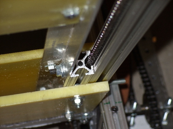

Limit switches on a lift -- best practice
So, I'm porting over our 2012 Robot to Java and I was wondering about how best to use limit switches within the confines of the command-based template. OI runs the raise/lower commands while a button is being held. Would it be best to put the limit switch code within the subsystem methods like so:
Code:
private CANJaguar liftMotor1;
    private CANJaguar liftMotor2;
    private DigitalInput upperLimitSwitch;
    private DigitalInput lowerLimitSwitch;
public void initDefaultCommand() {
        // Set the default command for a subsystem here.
        setDefaultCommand(new ArmDoNothing());
    public Arm() {
        initCAN();
public void doNothing() throws CANTimeoutException {
        liftMotor1.setX(0.0);
        liftMotor2.setX(0.0);
public void raiseArm() throws CANTimeoutException {
        while(!getTopLimit())
                liftMotor1.setX(0.1);
                liftMotor2.setX(-0.1);
public void lowerArm() throws CANTimeoutException {
        while(!getBottomLimit())
public boolean getTopLimit() {
        if(upperLimitSwitch.get()) {
            return true;
        } else {
            return false;
    public boolean getBottomLimit() {
        if(lowerLimitSwitch.get()) {
            return true;
        } else {
            return false;
(and as an aside, I've tested none of this, and I'm sure I probably did something wrong, but you get the point)
Or, would it be best to put the limit switch code within the Commands under execute() or isFinished()? Which I assume would go something like:
protected void execute() {
while(!arm.getTopLimit()) {
try {
arm.raiseArm();
} catch (CANTimeoutException ex) {
System.out.println(ex);
or
Code:
boolean stop;
    // Called repeatedly when this Command is scheduled to run
        if(arm.getTopLimit()) {
            stop = true;
        } else {
            stop = false;
        try {
            arm.raiseArm();
    // Make this return true when this Command no longer needs to run execute()
    protected boolean isFinished() {
        return stop;
Are they all more or less equivalent, or is there one way that has significant advantages over the others? Also, am I doing this completely wrong
