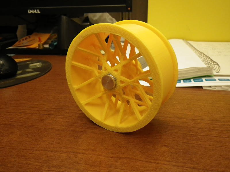

pic: 2175 Wheel v2

Re: pic: 2175 Wheel v2
What are the differences of the new version? Different type of plastic?
Yes, the black wheel is made of Altem, a stronger 3D print material. We ran into the problem that after 2 regionals we wore the hex out on the wheels, so we asked our friend to make us some stronger wheels.
Looks like your robot is going to need some re-inspection
Did your pneumatic arms ever get approved up in Duluth? I was the inspector that didn't actually do much because we were waiting on a ruling from the LRI.
Yes, they did get approved, but we decided not to use them... We made passive climbers that were able to be actuated for North Star. A lot simpler and safer.
The new wheels also have a stronger printing pattern around the hub. We did not start noticing wear on the origanal wheels until after a regional and a half. We also are using a much smaller hex shaft then we wanted (3/8) we ended up having to use this size shaft because all of the half inch bearings were out of stock.
Yes we got them approved, but ended up not using them because they would have crushed our new shooter we had installed. We added a passive ten point climber that actuated up for north star and it worked beautifully.
Coming from a team that is planning on 3D printing some wheels next year, what material were you originally using?
Glad it was approved, but they seemed a little over-engineered to me for a simple 10-point climb. Glad you guys figured something else out! Congrats on the regional win at North Star and I am looking forward to stopping by your pits at champs!
The original material if memory serves was abs m30, and the new material is Ultem about 2x stronger according to our printer friend
Could you send me a picture of the worn out hubs you're describing?
Glad to see 3D printed wheels are working for you guys, in at least some extent. I think they've got the potential to open up custom wheels for a lot of teams that may have not had that option available before.
I would be VERY careful with those 3/8" drive shafts supporting cantilevered wheels. Have plenty of spares ready and check them every match, and make sure they are a strong material (7075 AL or a nice, strong steel alloy).
Otherwise, neat wheels.
I'd be willing to bet that the 3/8" hex shaft is also a factor in the hub wear as well. Figure a 3/8" hex shaft is transmitting the same amount of torque through a significantly smaller area on the wheel than 1/2" hex, so it should be more prone to stripping the hub out.
Also, for those of you that are curious, ABS M30* has an tensile strength of ~5,200PSI and Ultem* 9085 has a tensile strength of ~10,400 PSI.
*Assuming that these materials are being printed using a Fortus Printer.... AFAIK it's the only machine that uses both of these materials.
Since our season ended, we have been doing some experimentation with 3D printed wheels, too. Here are a couple of our results:
More pics here:
https://picasaweb.google.com/1099928...eelDevelopment
The latest version has the spokes as internal structure, with fairings on the outer surfaces. We'll print some graphics or lettering on the outer fairing in a contrasting color.
Fun experiments, but we were so happy with our Colsons this year that we'll probably go that route again, unless there is a compelling reason to switch.
Ill try and find the wheel at the shop tonight and upload it later. we believe the reason for the failure was because of the less then ideal shaft size causing the forces not to be distributed over a large enough area in the wheel. What size shaft do you guys use it looks like 3/4.
Also the 3/8 shaft is steel (not sure the exact alloy) and they have held up through 2 regionals plus practice in the shop, i dont expect to see any failures from them, but we have two spare drive sides that we can scavenge off of if they start to fail.
We used 1/2" alum this year. I believe we did 7/8" in 2012 and iirc we were rolling 1" hex in 2011. I'm too lazy to embed, but here's a link to the entire 2013 assembly (4" wheel). The back end of the axle is unfinished in this photo.
Your wheel pictures have been a major source of inspiration for us. Out of curiosity, what is the weight of one of your 2013 wheels with the tread attached? How wide is your tread, and how is the tread holding up?
At some point, we are going to have to make a decision about whether the benefits of printing wheels is worth the time it takes. Right now, we're just playing, to see what is possible.
Todd F.
