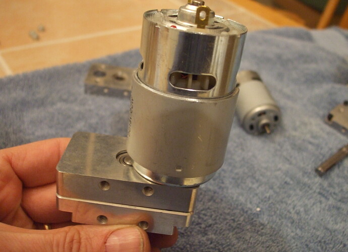

During our last match on Friday at championship we had a slight problem with our bumper brackets.
We also bumped in to pink team (233) during the same match.
Notice the corner of the frame.

At Hub City we had a pretty fun collision with 16 . You can see the numerous places our frame split. We Covered the whole thing in tin foil and had it rewelded (This time without the faces being ground off). No issues.
I have to say, I have little sympathy for people who go to all the trouble of welding up a frame, only to grind all the reinforcement off. As you discovered there, unless you've done a proper bevel prep on the edge, a butt joint is quite likely to have low penetration and little fusion of the base metal. And so you can end up with fractures that follow the original seam quite impressively. Any time one of my mentors suggests we weld something up and grind it flush, I give them the evil eye and they usually decide that perhaps we don't actually need to grind it, actually...
When you drop the frame off to be welded and it comes back like that, you dont really have much of a choice
I've just always stayed with the frame while it gets welded to make sure it was done right then put it into powder.
Erm. Well that certainly is a problem. Maybe proper weldment drawings in inventor with callouts for the welds? Then you'll atleast have papers to shake at someone when it comes back that way.
Who'd you have weld it up that didn't know that basic rule of welding, anyways?
Our sponsor who is world (And technically out of this world) class. I dont think the welder knew the kind of loads we abuse our machine with and thought it would look nicer (that part is true). We sent them some pictures after we had a good laugh about it, and we'll be collectively sure to make sure to be extra concerned with exposed frame.
The kids managed to drive an entire match without noticing, and we're pretty sure 16 hit us on our exposed face with those huge claw things they had at the time. A full speed collision with something like that would probably cause a lot of frames some grief.

The problem with welding thin items like this is that full penetration welds can easily become full-blow through holes. It does look like no weld-prep was done, but if you don't call for any you won't get any. The other factor is to look at the teensy weld section you'd end up with.
A better approach is to bevel, weld, grind flush, and then put a doubler plate over the joint and a fillet weld around the doubler, which will end up with about 10 times the shear area you have there.
It's hard to see how the inverted-V is to fit in, but it also has very little to work with.

A flush weld with the proper relief bevel and penetration would have been fine (it was 1/8" wall 1x2 6061 tubing). Had the welds not been ground flush it also would have been fine (as was the case for the NASA repair welds on one side only that lasted another regional and the championships). We told our sponsor NOT to grind these welds but after they were smooth and sexy the welder assured us that there was plenty of penetration. Lesson learned... we should have sent it back.
