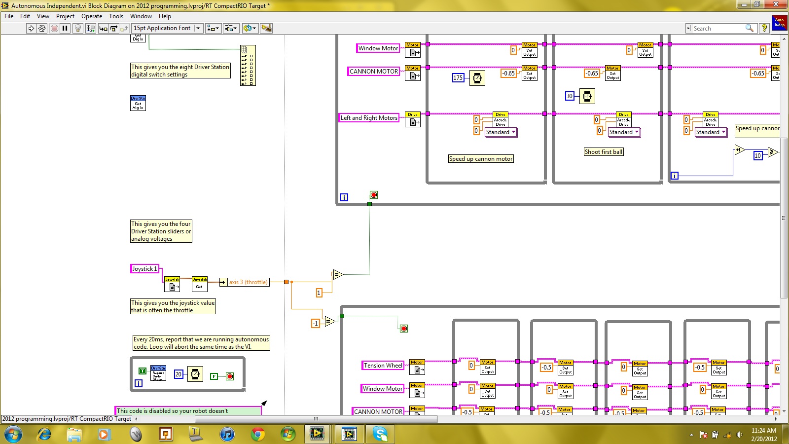

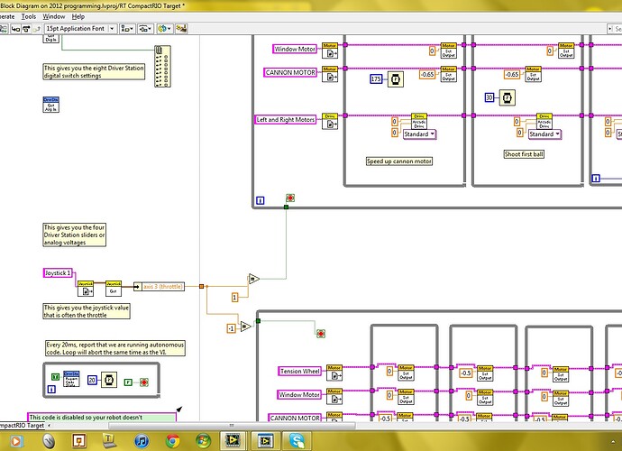

Re: Version Control Systems
We have used github and dropbox in the past. As far as getting multiple people working on the same code it eventually goes back to the one computer 5 or so kids crowded around because they normally flock to the main programmer.
As for code retention and version control It took 4 years to get a good system developed that the students actually followed. We just have multiple copies of code in at least 3 different places.
[img*]http://i.imgur.com/Os2oTET.jpg[/img*]
