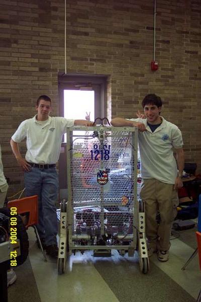

1218 also had a triwheel design in 04.
Here it is- http://www.chiefdelphi.com/media/photos/17468
http://www.chiefdelphi.com/media/photos/17025
http://www.chiefdelphi.com/media/photos/17027
http://www.chiefdelphi.com/media/photos/17026
http://www.firstrobotpics.com/wp-con...004/1218-1.jpg
