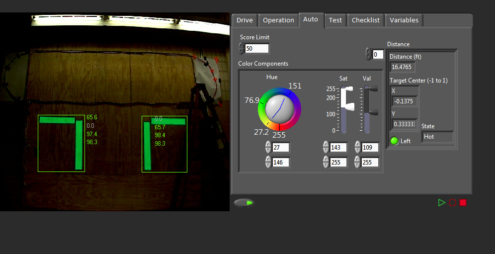

I have spent the last week or so modifying the dashboard to be able to process the vision system for this year's game.
![]() As you can see above, the dashboard is able to take our live incoming image and give back the specific scores pertaining to left and right, etc. We can also see the distance to the wall (not pictured because it's cut off currently, and it's also a little off on the math). With that information and knowledge handy, I'm completely stumped on how to integrate it into the teleop or autonomous VIs and make the robot do things (such as move to 10 feet away from the wall, or turn 60 degrees to the left, etc.) based on score or distance away. If anyone considers themself a guru of vision, any help with pictured examples or a .pdf or something like that would be fantastic. |

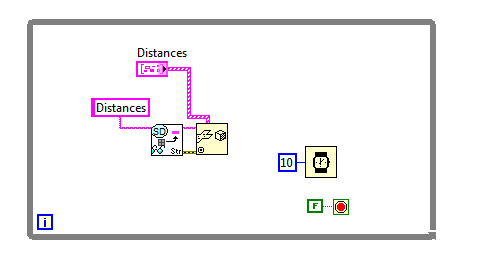

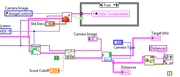

Alright, I've flattened the distance information to a string and did some poking around with SD/NT and I'm getting pretty confused. I've got it writing a string array to a SmartDashboard table which, like the tutorial shows, calls it "Distances". I was seeing some Network Tables .vis that were calling for the cRIO IP address to start communicating information but I know absolutely nothing about it and I don't know how SD and NT relate to each other, if at all. Though I've got a hold on reading it on the robot once the information is received (as far as I know, I haven't done it before), what's the next step for establishing a TCP or UDP connection in the Dashboard the Robot? I feel like it's right there in the Network Tables palette but I can't figure it out.

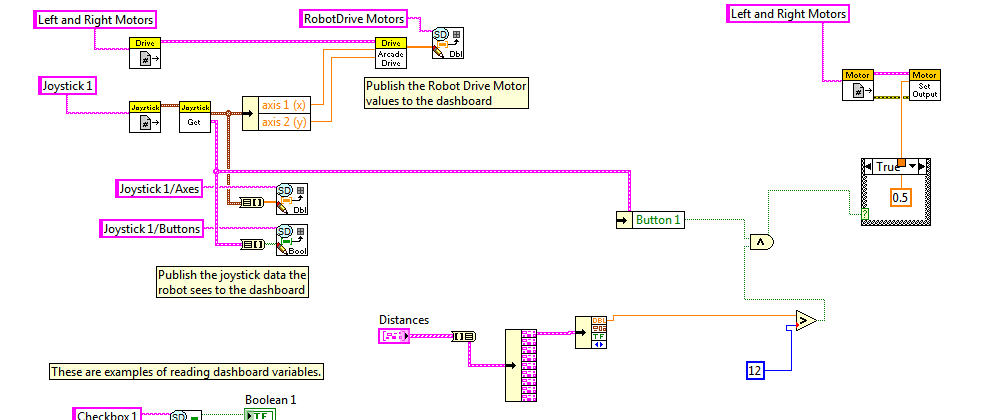

#14
Re: Processed Image > Robot Movement Help Needed
Okay I have the dashboard flattening Distance information to a string, and then sending it to SD Write String, which should put it into it's hierarchy or whatever. Now in the PeriodicTasks.vi I have placed a SD Read String and made it unflatten the string like this:
