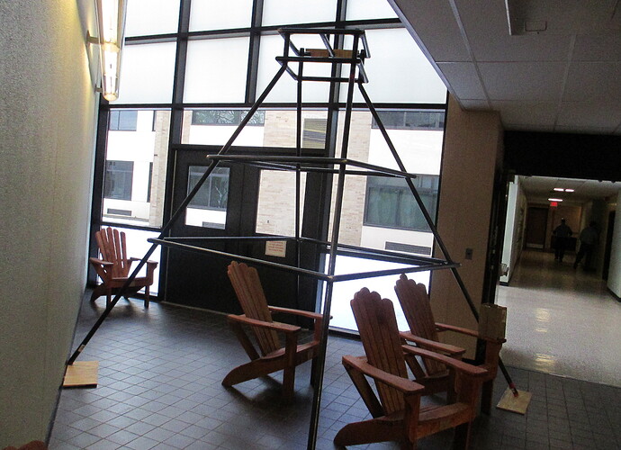

Unread 06-02-2014, 14:09
who716's Avatar
who716 who716 is offline
AKA: Stephen Kalogiannis
FRC #0716 (Who'sCTEKS)
Join Date: Feb 2012
Rookie Year: 2011
Location: Falls Village Connecticut
Posts: 424
who716 is a splendid one to beholdwho716 is a splendid one to beholdwho716 is a splendid one to beholdwho716 is a splendid one to beholdwho716 is a splendid one to beholdwho716 is a splendid one to beholdwho716 is a splendid one to beholdwho716 is a splendid one to behold
Re: Show off your welds!
unfortunately, we do not weld our robot but funny you should make this thread cause every year, the Drive team is fascinated by how smooth a perfect the welds are done on the driver station, im sure its done by a machine but every year the first thing we look at is the welds.
I would be stunned if a robot was used to weld such low-volume items as the player stations. A professional welder, or even a good amateur welder, can make some incredible looking welds.
