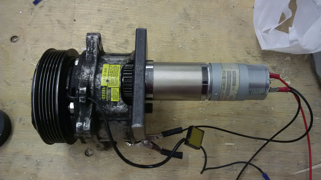

Is this Legal? Magnetic A/C clutch, AndyMark gearmotor combo
Hi guys
I'm a mentor on 4936, a rookie team from Tecumseh Ontario.
We're trying to finalize our mechanical today and I was hoping someone might be able to give me a quick legal/not-legal ruling on our winching rig.
It's an AndyMark gearmotor linked to the 12v clutch from a A/C compressor.
Ignore the wiring, it's just "make it function" stuff, it'll all be rewired with relays and limit switches.
Thanks, Ted

Are you electrically actuating the clutch or are you just using the setup as a pure mechanical system? R29 should answer your question.

You have to supply/remove 12v to the clutch to lock/unlock the pulley to the shaft.

Q&A 144:
Q. Are electric clutches allowed? And if so, can they be run from the solenoid breakout card since they are essentially a fancy solenoid?
A. An electric clutch is considered a solenoid actuator, and thus limited by R29.
https://frc-qa.usfirst.org/Question/...fancy-solenoid

The other is R11. Is this part considered COTS? And, if so, does it fall under $400? I am going to look some more to see if I can find something regarding automotive parts reuse. if you can price up the part number
EDIT: I don't have access to the black tote automotive parts recycling product donation voucher. See if it has any wording on this type of item. It may only cover motors, though.
I did find this to be a Volvo S40 compressor, and found one source for a price of $490 for a new unit

It's a junkyard item, owes me $10.

oh, and the applicable portion of R29:
Electrical solenoid actuators, no greater than 1 in. stroke and rated electrical input power no greater than 10 watts (W) continuous duty at 12 volts (VDC)
You will need to bring in and provide a datasheet for the clutch that specifies stroke and input power.

I seriously doubt this solenoid is 10w or less.

Hmmn, this could be a problem.
Google is all over the map on expected amperage draw for A/C clutches. everything from 0.75A to the teens...

How about measuring it?

You could try measuring it yourself, but I don't think that counts for anything. The inspector will want hard documentation from the manufacturer.

I don't think it is legal. It have to be a solenoid @ less than 10 W. Hard to document. It would not fall under the Automotive recyclers PDV since it is not a motor.
It should be though based on it being a really cool idea nicely done.
