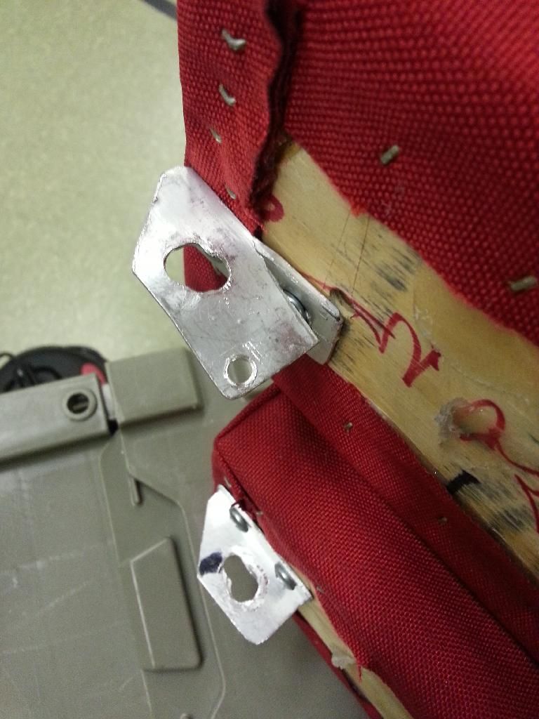

This was a bumper mount that had been ripped and the bolt holding it on was stripped through the frame. This happened from inside the frame contact in QF 1.1 and was not penalized and resulted in us being disabled.

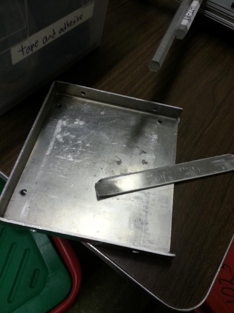

This was a battery tray. the bent part snapped and broke after a high speed hit in QF 1.2. Did not affect anything for that match, but it still was a hard hit.

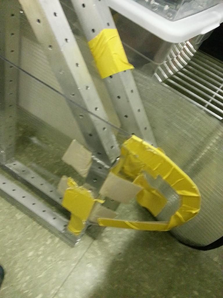

We had some complications with our shooter at Palmetto.
Turns out, the 1x1 versaframe couldn't handle the force of our hard stop and over time began to crack. Eventually, our shooter basically just broke in half. Thankfully it happened during testing in the pits rather than during a match, but it was not fun to have to replace the entire thing.

Just to be clear this is because of a catapult hard stop right? We are using the versa frame as well but not for the same application.

Folks, the 1" x 1" Versa Frame is only .04" thick. It's a really bad pick for serious structural applications.

Do I want to know how you found this out? Or are you just saying this because of the fact its .04 thick?

Just saying this based on the thin xsec. We didn't use any Versa Frame.

It's hard to pinpoint what exactly caused the system to fail, but it was likely a combination of the hard stop, the amount of force we were bringing the catapult down with, and a human error where we left the shooter clipped to the frame and ran it, putting loads of stress on the entire system. (interestingly, that misfire sheared our gears first). We were using the versaframe profile shooter on our practice bot and it seemed to be holding up fine, but now I'm questioning when that one will fail, if it's not about to already.
