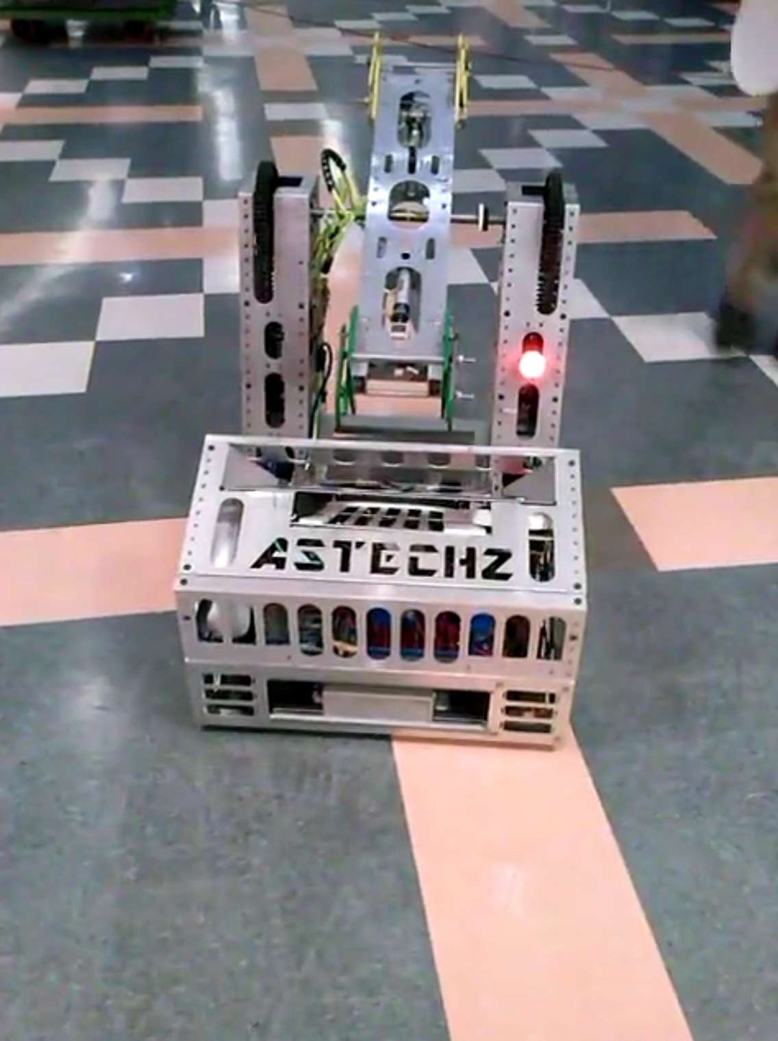

Re: AndyMark 3CIM Single Speed Gear Box
I have an image, but it's missing a miniCIM at the top.
http://i.imgur.com/kj65I7O.jpg

Thanks for the pics. Definitely not enough room in our drive base for those to fit. Oh well...
You should sell those yellow corner braces for the AM14U! We had to whip up something similar a day before bag-day on account of bent churros.
