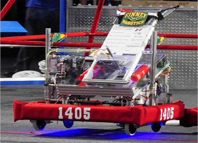

I seem to notice at some points your kicker getting stuck on your ball input mechanism. Is this intentional?
#3
Re: 3324 The Metrobots - Ready for Queen City Regional
No, earlier in the season we had a problem with this happening every once in a while, we then found out that the code was making our potentiometer that was measuring the kicker axle turn drift around 10 values every kick... we may have destroyed a few aluminum shafts, as a further precaution even though the problem has been fixed we switched to a tempered steel axle on the intake.
