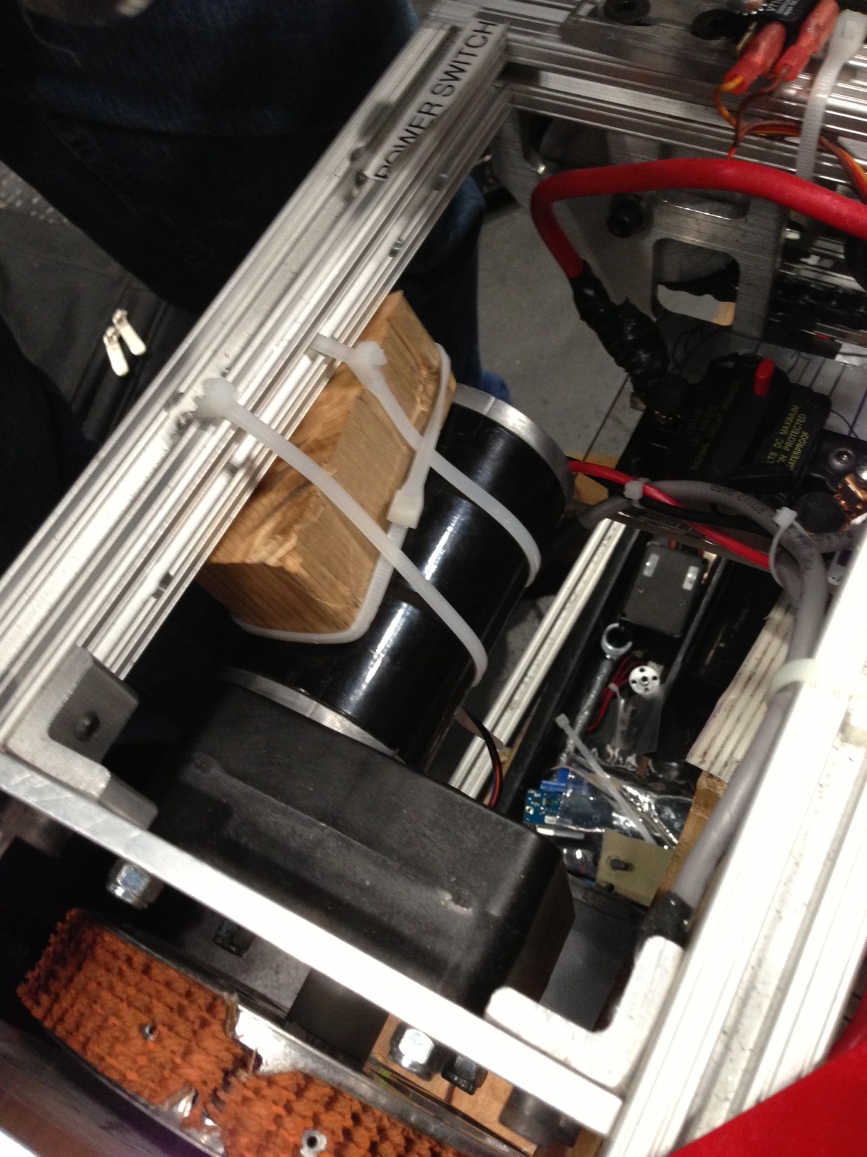

is it legal to have LEDs on robot
It's controlled by an IR remote for decorative purposes only. As per R73 of section 4 in game manual, it could be considered legal, but we would like everyone else's opinion on it.

Briansmithtown has a reputation beyond reputeBriansmithtown has a reputation beyond reputeBriansmithtown has a reputation beyond reputeBriansmithtown has a reputation beyond reputeBriansmithtown has a reputation beyond reputeBriansmithtown has a reputation beyond reputeBriansmithtown has a reputation beyond reputeBriansmithtown has a reputation beyond reputeBriansmithtown has a reputation beyond reputeBriansmithtown has a reputation beyond reputeBriansmithtown has a reputation beyond repute
Re: is it legal to have LEDs on robot
-Kris
Our Programmer, Peter(Petzer) thought of the idea, but of course I kinda feel a bit more comfortable with not taping, but if we have to, then we will
~Brian
