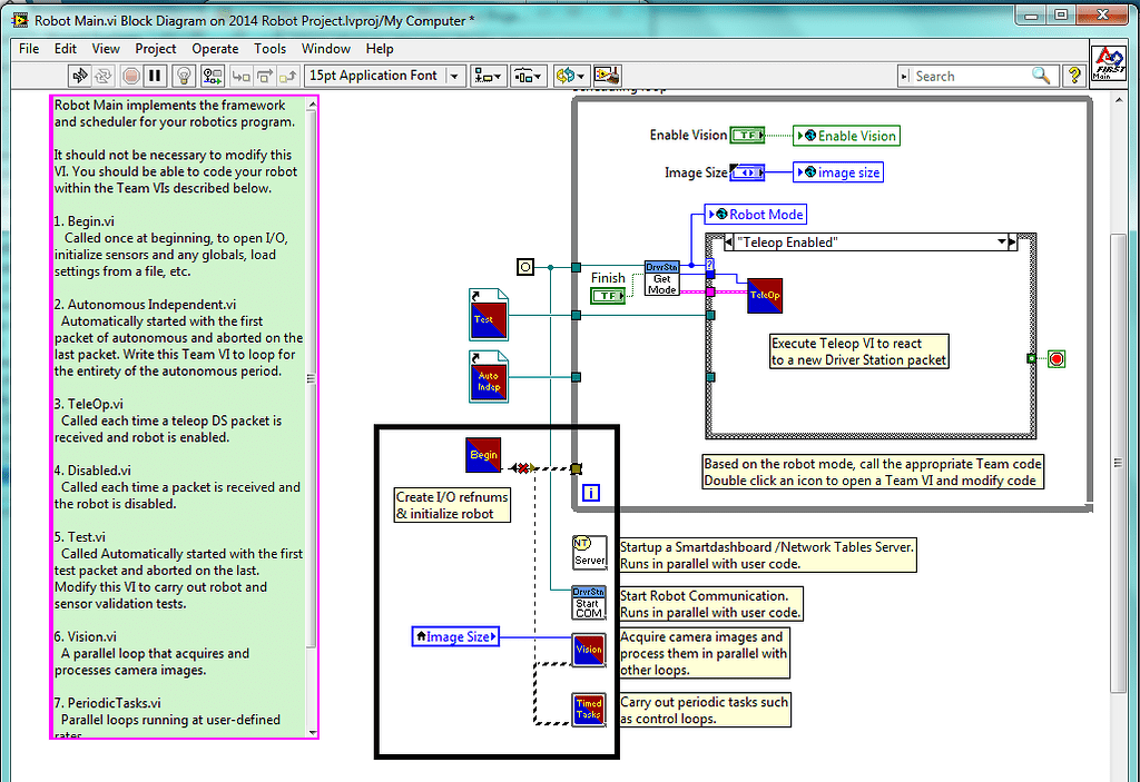

Hey I just finished programming the linear actuators for our team but i have this problem. My linear actuators are supposed to lift at the push of a button until it hits the top switch then come down at the push of another button until it hits the bottom switch. All that stuff happens but the code updates the jaguars irregularly. Like update-wait for some time-update etc. I think it might be the way my loop but i am not sure. Could you guys check it out? THANKS!!!

You have a 5 millisecond wait in the "Allows actuator movement Downwards" case. Why?
How are you ensuring that you aren't simultaneously sending two different commands to the Linear Actuator0 motor?
There's a lot of nearly incomprehensible stuff going on at the left side of your picture. What is all of that supposed to be doing? (If it's what I suspect, you can probably replace it all with two feedback nodes and a couple of boolean functions.)
Is all of the code inside one of the timed loops in Periodic Tasks? If so, which one?

Ok.The code is in the timed tasks vi. The code at the left side is a toggle switch for the joystick input. If you could show us a better way of coding it we would be grateful! I am pretty new to labview programming so I am not sure if there should be a wait or not, I saw it there so I didn't tamper with it.
Is it outside all of the timed while loops in that vi, or is it inside one of them? If it's inside a while loop, which one is it in?
If you can tell me what you want the code to do, I'm sure I can show you an efficient way of telling LabVIEW how to do it. The phrase "toggle switch for the joystick input" isn't enough detail for me to know what you want.
There are specific places for wait functions, and specific reasons for using them. Besides the timed loops in Periodic Tasks, the only place I think I have put them in a robot program would be in a flat sequence in Autonomous Independent (or a flat sequence in Periodic Tasks, but that's a very special case).

It was inside the "10 ms tasks" loop but in an attempt to reduce lag I changed the wait time on the timer to 5 ms.
We need the code on the left to make a button on the joystick toggle a Boolean value. Which we will use to tell the actuator to move or be stationary.
