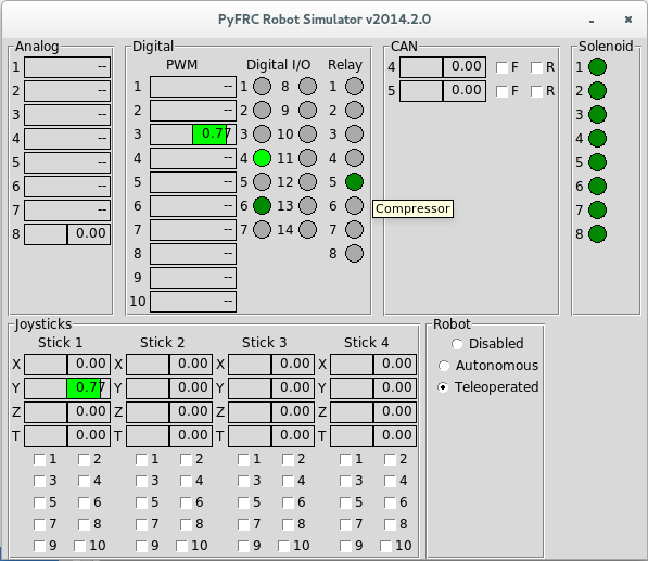

#15
Re: Team Titanium 1986 Omnidirectional Drivebase
That is an interesting one joystick method for field-centric control. If I understand it correctly it would always adjust to point the robot's intake in whatever direction the robot is moving. Not a solution for every situation, but a viable option for some.Right now we are trying to think through how using a robot-centric camera to aid the driver in blind areas of the field would mesh with a field-centric driver input. Whatever we decide our drivers are eager to log the hours needed to master the controls. It's been years (2008, 2010) since we've done an omni-directional drive-train, and this thing is just fun to drive. |
