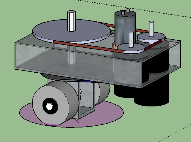

pic: ABS-110, lightweight 2-speed PTO gearbox

Really liking this design
Because this is a 3-position piston, does that mean that when the PTO is engaged, the robot won't be able to move around?
Also, what is the PTO capable of doing? I'm not sure if a 5:1 ratio might be enough to, say lift the robot's weight off the ground.
Finally, where can I find the ballshifter PTO? For the dog PTO I did, I had to rip the hub off of a .step file from a wcp gearbox.
-KohKoh

Yes, the robot can't move when the PTO is engaged (like it should).
The PTO is going to a 22t sprocket. I would most likely route it to a 40+t sprocket to lift anything (like the robot) or route it to another sprocket and gearbox next to the mechanism. Given that you would be using 4 cims to lift things, a 12:1 gear reduction should be enough for a linear climber.
I had to design the shifter shaft myself. The idea is that the shifting is on the upper shaft, so whenever a gear is engaged the other gears are not. This also enables me to use only two shafts.
The Vex ballshifter shaft requires at least a 34t gear and uses a 3/4" shaft, plus only has two positions. Using a 3-position 1/2" steel shifter shaft enables the use of a tiny 20t ballshifter gear, and reduces the size of the gearbox considerably.

From the title at first I thought this was an ABS gearbox and I was concerned. Looks good though! Generic comment about supporting your CIMs marginally better goes here.
If a PTO left the drivetrain engaged, you would have no choice but to be driving your mechanism and the drivetrain at the same time. This is generally undesirable. Imagine trying to hang on a bar you are forced to drive away from, for example. The tradeoff of a PTO is that you can't use your drivetrain while it's engaged (plus the design hurdles).
Nothing about a PTO requires the entire gear reduction to take place in the same gearbox as the drivetrain. Rarely is this the case.

This latest round of gearboxes seems to be missing a very critical (IMO) component for the implied WCD setup they're for: the outer bearing block for the direct-drive wheel. Would adding that bearing block (such as the WCP one) cause issues? It simply requires adding two extra threaded holes around the existing output bearing hole.

I've never designed a PTO gearbox, but this one inspired me to think about it more... as I was thinking about it more, I couldn't come up with how a gearbox with a single shifter shaft / output shaft could be used to get a PTO... After having thought about it a bit more, it seems to me that it requires having 2 shifter shafts OR having the shifting shaft not be the output shaft.

I had a look at your ball shifting shaft and the shaft itself looks fine. I found it interesting that you made the shaft wall 1/8 thick so the balls can't fully engage, that might be a problem with wear depending on gear material and tolerances but it could very well be totally fine.
What I am very concerned about is bearing load. Its seems you're using R1212 bearings and according to lily bearings (http://www.lily-bearing.com/ballbear...12-bearing.htm) they only have a dynamic load rating of 111 newtons and static rating even lower. These numbers may be very conservative (or just wrong) but I would recommend doing some math and researching the ratings of the actual bearings you'd use to see if they'd work. If not, look into bushings or bigger/different bearings.

Interesting that you noted that. All of my other gearboxes have a better cim support, but I elected to forgo it in this case due to the lack of demonstrated need for one. A couple of my old gearboxes which were actually manufactured did not have cim supports and functioned ok, and I figure that will hold true for this as well.
I was planning on not using a bearing block on this one and instead directly pressing bearings into the 2x1 and using a double sprocket, however I will add mounting holes for the WCP bearing block just in case. Thanks for the idea!
I am using Boca SR1212-ZZ, which has a stated dynamic load of 94kg (207lb). I figured that would be enough for these, but I can swap them for bushings relatively easily if needed; that would also remove/reduce the need for spacer shims.
Thanks for pointing that out.
The balls should be able to fully engage with the grooves in the gears. I made sure that the balls wouldn't be able to "get stuck" in the grooves, but not so much that it wouldn't engage. What do you mean?

Nailed it! That was my thinking exactly; I've struggled with this problem in the past.
