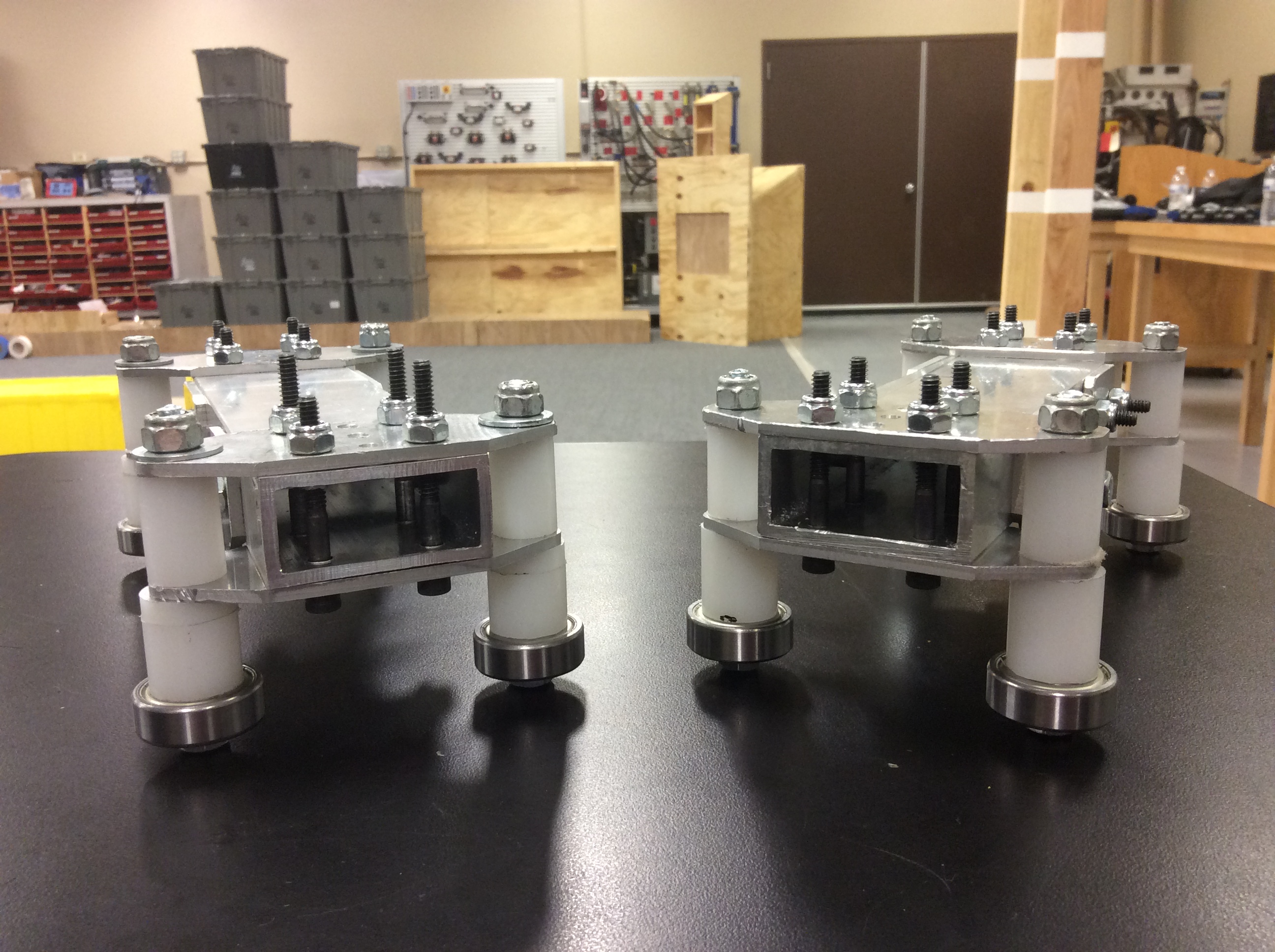

Re: Has anyone made a swerve drive that's run on one motor?
Originally Posted by Chak View Post
.... Well, strictly it's not 3 CIM, ...
...because, strictly, three is not equal to four. And the little monster had two FPs as well, bringing its total propulsion power nearer to that of six CIMs. Underweight and overpowered -- the thing could fly.
