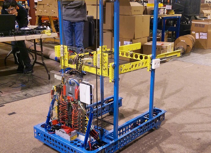

You can use the 1inch REV extrusion for this also. The reason we have 5 holes in the end is so you can put multiple screws in to prevent twisting in the mounts.
You can see an example of this with the Rhino Tank drive where they are integrated. ![]() |
