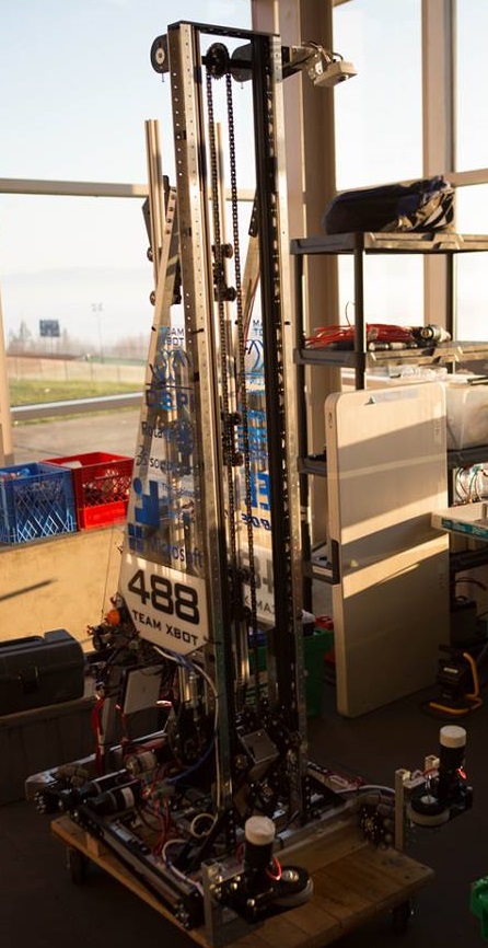

I noticed that after running our Rhino drivetrain around for a little while that the bearing supporting the drive shaft on the outer plate has slipped along the shaft and was no longer giving any support. The bearing could be easily pushed in and out with finger pressure. The flange is on the inside so the bearing ran along the shaft rather than fall to the floor. Looking more closely we saw that the bearings on the inner plate were also very loose. This happens on at least three of the four rhinos we have.
For the drive shaft we can add spacers and there's always Loctite, but has anyone else seen this? |

Typically flanges bearings will ONLY guarantee the bearing won't move in one direction. Even if you have a tight press fit on the bearing, it will loosen up over time. So, it's important to make sure you constrain your bearings in the other direction as well! This can often be done with spacers - we keep some 1/2" ID PVC pipe on hand to cut to the proper length when needed. It can also be done with shaft collars, or if you have a lathe you can cut a groove and use an E clip. In fact, we're using all 3 of these methods on our robot this year!

Likely nothing was missed. I noted the surprising lack of spacer/retention for the flanged bearing on the outer plates(when oriented with the flange inside). This confirms my suspicion though that a spacer should be added.

As you observed, the light press will not retain the bearing. It might be worthwhile to ask AndyMark. They are very supportive of their products.

Yes I posted about that in another thread here, and even talked to Andy about it. We put a hex collar on the shaft rather than a spacer.
#9
They didn't miss anything. Bearing is supposed to be "press fit" but the hole in plates are not quite press fit

Would a drop of 'LockTite sleeve retaining compound' help close the distance in the bearing press fit?
I've used that before on slightly worn, or shafts designed to be undersized for plating but were not plated, to hold things in place. Better to have the plate machined properly but in a pinch... |

We occasionally drill a small hole next to bearings and screw in a sheet metal screw so head just touched the bearing.
