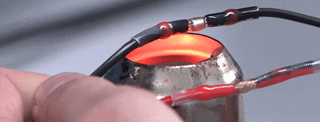

We also released two things:
1) This how-to video so you can see the process for yourself.
2) This rather satisfying GIF of the solder melting in:

We've used them for making PWM Y-cables many times and they have served us well. The finished splices are stronger than the wire at either end. We have never tried them on wire larger than 22 AWG.
They do require a lot of heat to melt the solder cylinder within, much more than most wire insulation can tolerate, so some care is needed to avoid damaging the wire insulation.
I've used them at my day job (NASA). They definitely do require more heat than many other things that require a heat gun.
My use cases have been when we need to solder a wire to a braided shield (surrounding the wires). I do not know if that is the main purpose of them or not, but soldering a wire to a shield can be either tricky or difficult to provide a strong mechanical connection.

Another recommended process includes mechanically interleaving strands of the two wires to be joined. Less risk of cold joint.
