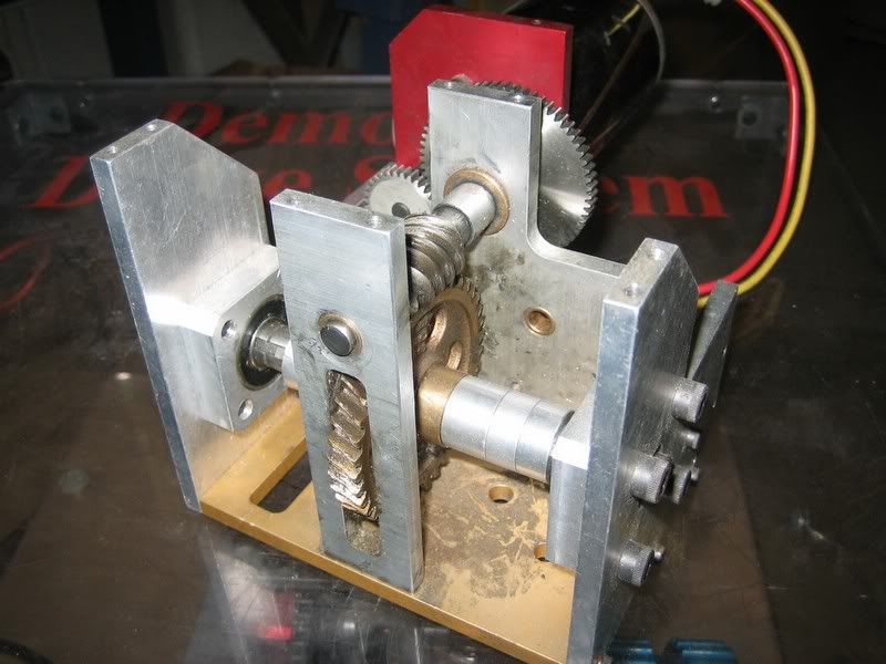

My old high school Team 195 used the a worm gear setup in 2002 with much success. I will try to swing by the high school today and snap some pics of it for you. Also in 2002 we used the no backdrive feature to our advantage. We had grippy tank treads, when we shut down out motors the only way to move us was to drag the robot across the carpet, no small feat with ~120 square inches of gum rubber on the floor with 130lbs pinning it down. Anyway if I grab the pics i'll toss them up for you.

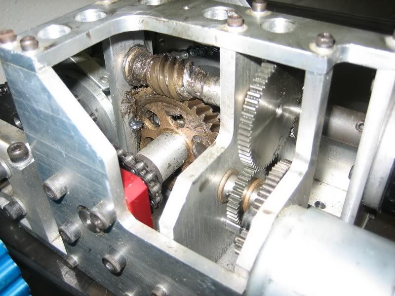

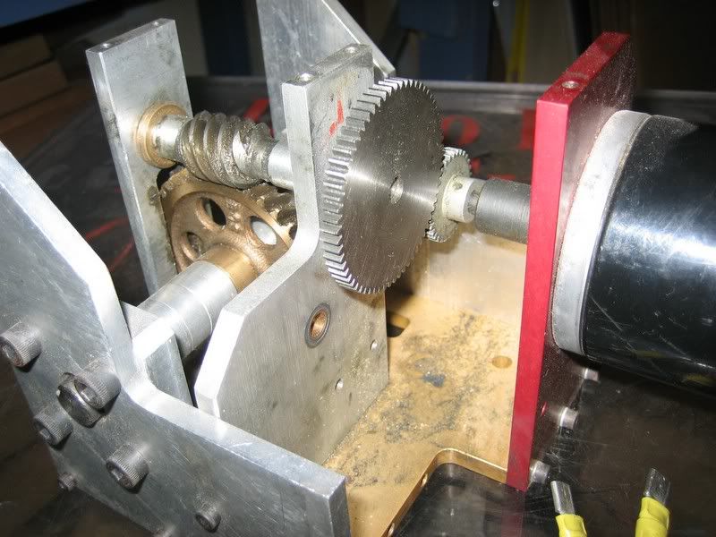

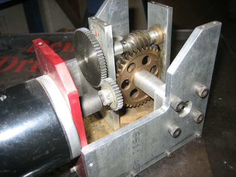

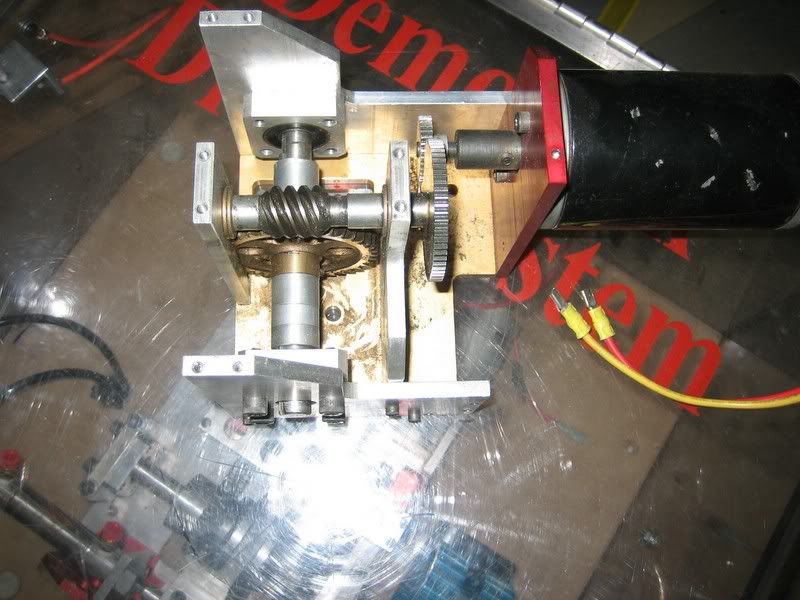

Thumbs up Re: Worm Gears WARNING PIC HEAVY
Here are the pictures I promised, all the gusseting was very necessary due to the massive torque of the drill + CIM motor. It had a tendency to pull the worm away from the gear and de-mesh the two. This had the cute effect of turning the worm into a downright end mill and shaving the teeth off the brass gear quite nicely. Also the center gear was made out of soft brass to be a sacrificial gear of sorts. This allowed the worm to mate itself very nicely with the gear, albeit, with a few chips in the bottom of the chassis after the first few runs with a fresh gear. With this setup we had to change the center gear about every competition and a half.
Owch!
