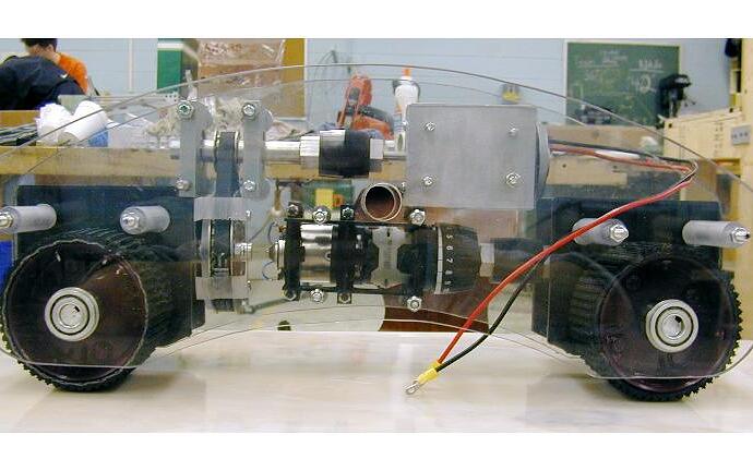

Ok,
Our mentor wants to build a chassis that pivots on one side. His reason for this is he says that the floor in the arenas will be uneven and he's worried about the wheels coming off the floor. Has anyone had any problems with this? Please let me know ASAP.

I've never heard of uneven floors before. I wouldn't worry about it unless it is absolutely critical to your design. Most fields are on a concrete slab floor, etc. so level shouldn't be too much of an issue.

Unless you are using a holomonic drive system, this shouldn't be a problem.

We ARE planning on using one. We actually are building our wheels right now. Last year, I saw many omni-drive robots that didn't pivot and didn't have any problems. What do you think?

Then it's probably worth it to have the base pivot. If you are driving and hit one little bump in the carpet, you are going to go off in some crazy direction.

ok, Do you have any good ideas on how we should do this? We Have one idea, but thats it.

We used a holonomic system last year, and managed to pretty much conteract the bumps in the floor and the loader platform by using high traction, neoprene "rollers" (we used the Andymark Trick Wheels). Additionally we made sure all 4 of our wheels were co-planar, so that they would all 4 be in contant on a level surface.
So, unless your planning on tackling the ramp with a holonomic system (which could be done with a custom active suspension, but would be very very difficult), you shouldnt need anything special.

if you're REALLY worried id just go with a more flexible frame. more twist itll keep all tires on the ground. less flex is waht we aimed for with 4wd this year tho. our stiffest chassis yet. and well softer tire compounds may help too.
but overall other than carpet being ripped up about 2 times in my robotics career . i cant really think of uneven ground affecting anyting

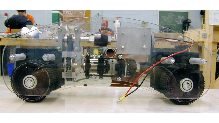

Send a PM to Ken Stafford from WPI. They had a flexible frame last year.. it was really cool.
I'll try to fish up some pictures and upload them later.

And Tom Bottiglieri, if you could please upload those pics I would appreciate it.
