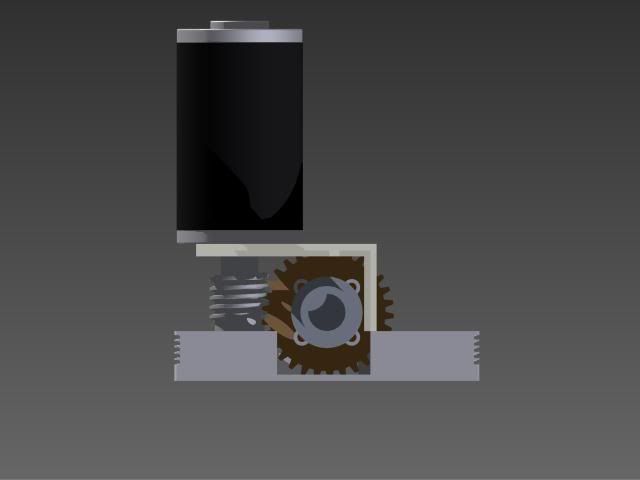

Worm Gear Drive
I know some teams I spoke to this season mentioned problems with worm gears breaking. What are the best ways to build a gearbox with a worm drive included? What are good material choices and types of gears? Both for arm applications, or for drive train applications as recently shown by 269.
If you have built a worm drive gearbox what were some problems you experienced, and what are some tips and tricks you would recommend?

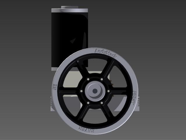

We had our boxes custom machined, and used a worm gear from Boston Gear and a brass gear that gave us a 15:1 ratio. We could've used a 12 as well.
I'll post some drawings on our boxes in a sec.

Alright, here is the gear we used was a
Boston Gear WORM, 12 DP, 14.5 PA, 1. PD, LH, STEEL/UNHARDENED
Part Number: DH1407LH
We used it with a 30 tooth brass gear.
As Elise previously stated, our worm-boxes have been super reliable and as far as I know, we have never had a problem with any of them.
Where did you get (or did you machine them yourself?) the wheel coupler for your direct drive?(the one that atatches the wheel to the output sprocket) I have looked in nemerous locations but could no find what I wanted (which is what you used).
PGHS Robotics Team #2073
www.pghsrobotics.com
That was custom machined.
