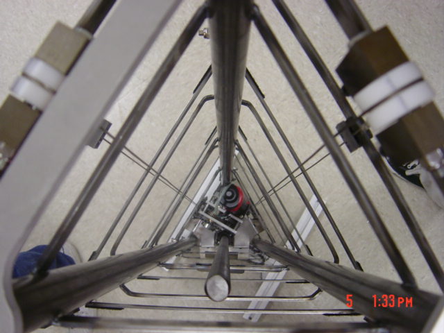

pic: IR Sensor on a Vex Robot!!
Re: pic: IR Sensor on a Vex Robot!!

How did you attach the board?
details on which one the ground ends up in (black orange white) and where the signal wires go? |
#6
The IR board itself is just Velcroed to the top of the vex controller. The wires coming from pins 5-8 on the IR board are going to the inner pin of 4 digital IO ports on the vex controller. The inner pin is always for the signal line, normally a white wire, though we made ours yellow. The power line is not used, and the ground reference was already the same because we powered the Vex controller and the IR board off of the same battery.
So my hypothesis was correct.
A lot of people were asking about how to hook it up to the big robot. So you just wire up spare PWM's (white wire) and use the outputs as regular sensors. |
