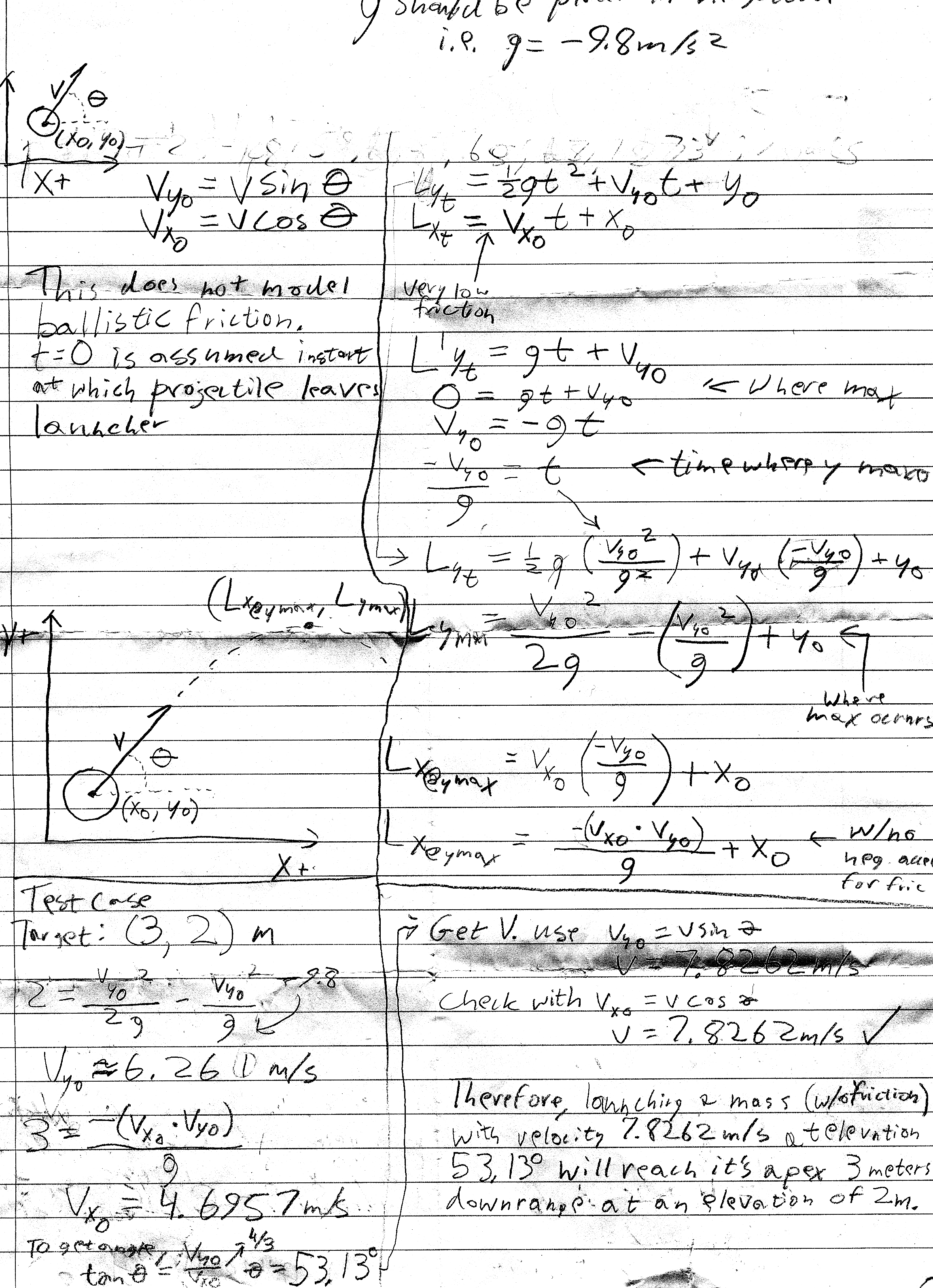

Originally Posted by Qbranch View Post
FYI I used a little calculus to figure out a way to calculate trajectories. If you know how far down range and how far up you want the apex of the ball will be, my equations will tell you how fast and at what angle you have to shoot the ball. If you all are interested, I'll post a scan of my piece of notebook paper.
-q
I'd be interested in seeing those equations. Math is always fun, especially when it's useful.
Ok, here's the (now well worn) piece of notebook paper that I did it on it Economics. Let's face it, the opportunity costs of doing it were very friendly since everyone can use a review of their calculus.
I'm sorry it's kind of hard to read in places, as i mentioned before it's not in the best shape anymore (has a few holes in it from folding/unfolding while we were designing our shooter). But, these equations have been empirically validated as accurate, so here you are. I know it got cut off but the top says "g should be put in negative" but you can see that in the test case down below anyhow.
Thankfully, the two really really important equations are clear and pretty easy to read Lymax is the Y location at which the trajectory peaks. Lx@ymax is the X location (how far down range) at which this Y peak (maximum height) occurs. The "test case" in the bottom 1/3 of the page shows an example using these equations.
If you have questions, please post. I realize it's hard to read, but it's also thankfully pretty high resolution, so just zoom in.
Click here to see the page (768k, png)
