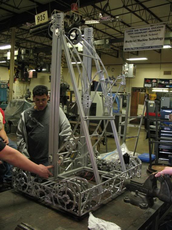

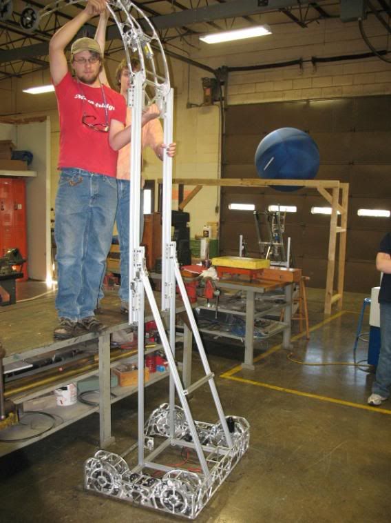

Team 935 as of 2-2-2008

I love that frame.

Agreed...All that machining is so sweet. How much does it all weigh? I love the roller idea!!!

Absolutely love it!!

I loved Newton's bot last year. Combined with 1775 in Kansas City, it was a very deadly alliance. Excellent chassis.

Thanks. When we weighed it we threw on our cable drums and our electronics parts and it weighed about 109 lbs, i think. I don't remember what it weighed without anything on it. I think it was somewhere around 100 lbs.

wow that bot weights that much!!! Where is it all at????

where do you guys plan on mounting your electronics? I dont see any place that is pretty good and covered to mount it.

well, the chassis weighs around 64 lbs and the elevator weighs around 36 lbs. We have a habit of building our chassis a bit heavier than many teams.
There will be a space right in the center of the chassis. That's probably where I'll end up mounting the electronics. We usually just mount them wherever we can fit them.

I wouldn't think that frame would weight that much

Regarding the weight of the frame- it's aluminum extrusion, isn't it? Bolting the entire frame must add quite a bit of extra weight, and extrusion is at least twice as heavy than box tubing due to sheer mass. Are you guys going to be a pushing bot? Weight would help there. A robot pushing the weight limits isn't always bad. Sorry, pun not actually intended.

ah i didnt see the bolts, i thought it was all welded

The chassis is made out of 1/4 inch aluminum that is cut with a CNC machine. There are no welds, the entire robot is bolted together with 1/4 - 20's. I think that the weight that I said earlier was with the battery. I had to include the battery when I was trying to figure out the robot's CG so I probably forgot got to subtract it from the weight. We probably wont be a pushing bot, we just have a habit of building heavy robots.
