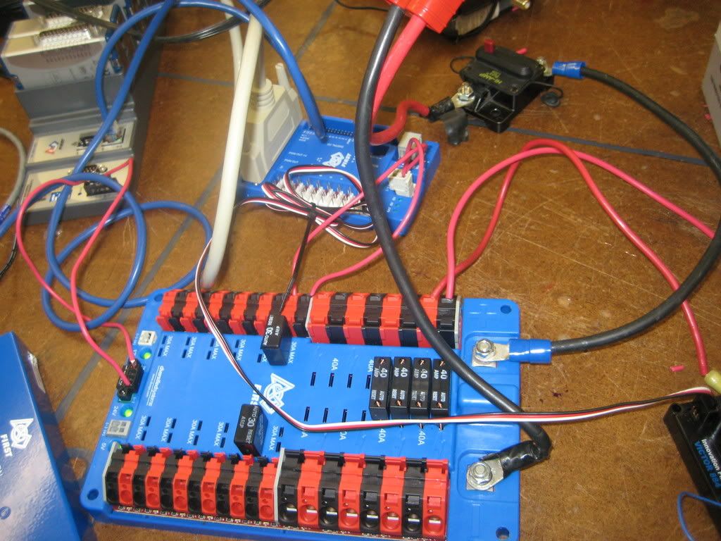

Hello everyone, I'm having troubles running a motor control example that is provided by LabView.
Everyone seems to be connected properly, the lights on the power distribution block, speed controller, cRIO and the digital sidecar are on.
The light on the speed controller seems to be flashing orange, so that means that the speed controller is not getting any information (?)
I have formatted the driver station and the cRIO successfully with update 2.
The program downloaded successfully also. The program that I downloaded is Motor Control Example. When I run the program and change the speed, the lights on the speed controller does not change. I have tried several things like switching from autonomous to teleoperated and rebooting everything.
I uploaded some pictures of the current control system and how everything is connected.
Does anyone have any idea on how to solve this problem?

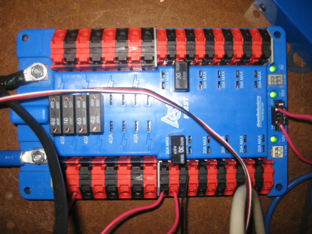

A couple of quick observations.
1) please fix your wiring - red wires for every PD output regardless of + vs. - and two black battery cables into the PD? You're asking for trouble..

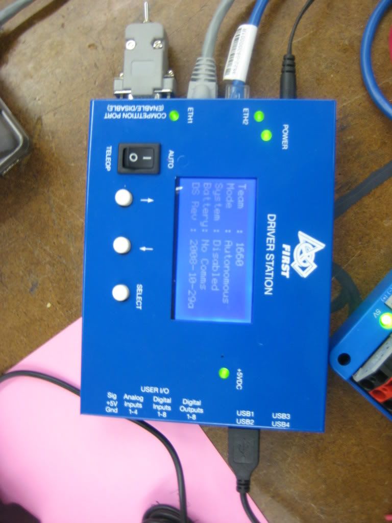

2) your DS clearly states "disabled", you need to use the toggle switch

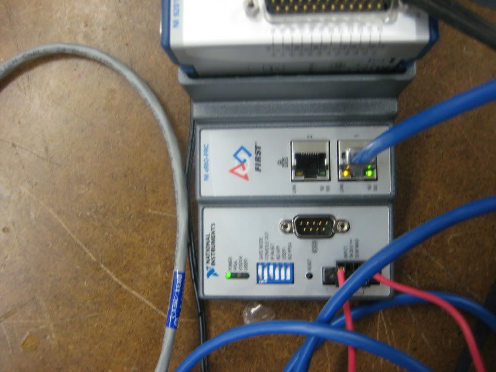

3) why are the safe mode and IP reset switches set on your cRIO?

Thank you for your response.
1) The wiring is only set up like this because the KoP only provided red wires. We are planning on going to Home Depot to buy black wires. Other than that, the wire color shouldn't matter.
2) We actually try with the dongle switch on and still did not work.
3) The safe mode and IP reset switches are set on because when we were reimaging the cRIO, it said to turn the IP reset and safe mode to ON. Can that be the problem?

Is the PWM wire to the victor plugged in correctly? I can't tell from the photos. Not only is there an orientation, but these are tricky to get actually connected; it takes a light touch.

I believe that the problem is with the driver station or the cRIO because when I test the Joystick input VI, the joystick values does not changes when I move the joystick.
I connected the joystick into the usb port before I turn it on.
On the driver station it displays:
Team: 1660
Mode: Teleoperated
System: Enabled
Battery: No Comms
DS Rev: 2008-10-29A

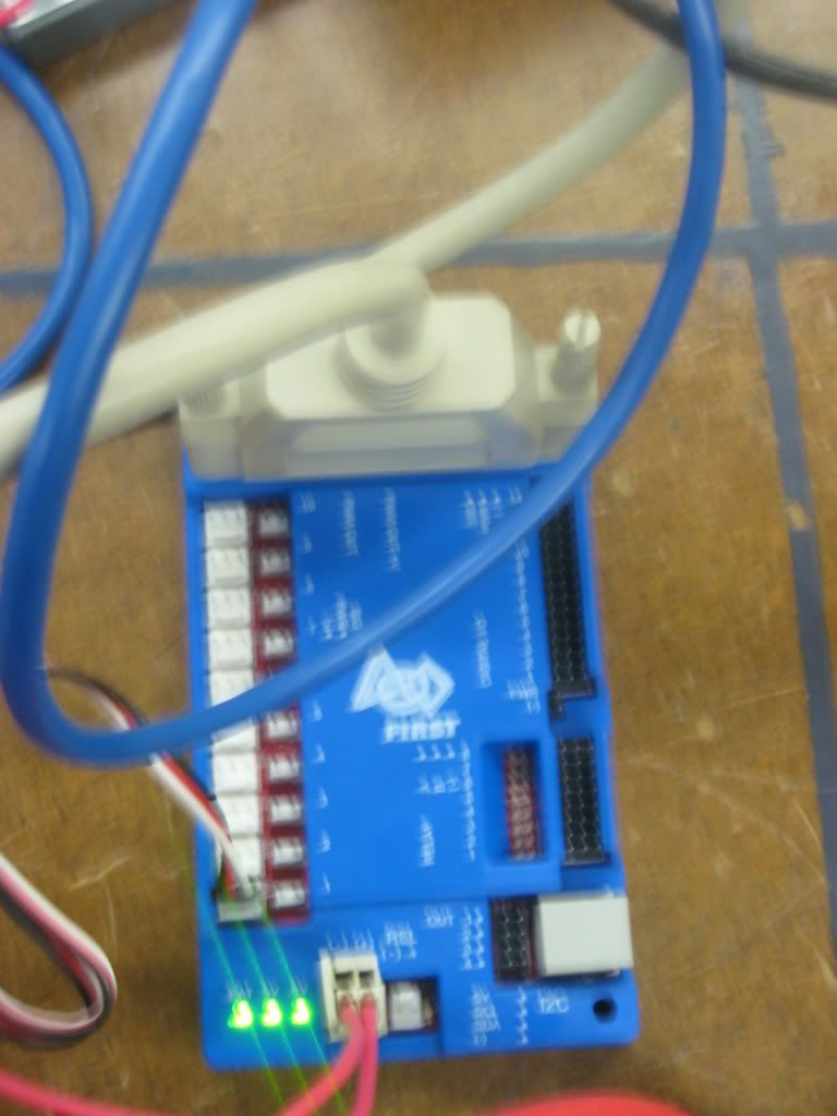

Are you certain the digital i/o module is in the right slot on the crio? I think the default is slot 4. If not, it looks like it would be 6.
The battery display on the ds is saying no comms because the analog breakout in slot one isn't wired up.
The light on the controller should be solid if its enabled and on autonomous.
Are the two lights next to ethernet port one on the crio blinking rapidly, or are they solid?
btw it might be helpful to see a photo of the top of the crio - what the breakouts look like etc.

Is it mandatory to wire up the analog breakout in slot one in order for this work?

The two lights next to Ethernet port one on the cRIO are blinking rapidly.
When I was imaging the cRIO it said to set safe mode (because the firmware on the cRIO was corrupted?) and IP reset to on. Afterward, it said it image the cRIO successfully.
Unread 10-01-2009, 22:07

You must turn off the cRIO "safe mode" and "IP reset" switches.
The only switch that you might want on is the "console out" switch.
On the DS, "No Comms" means the DS and cRIO are not communicating at all, so your program can't run. That is probably due to the IP reset having reset the cRIO IP to it's default of 10.0.0.2
Unread 10-01-2009, 22:51

When I turn off the Safe Mode and IP reset the status light starts blinking yellow.
When this occur I reflash the cRIO and it says to turn safe mode on and the IP reset.

As far as the analog breakout goes, it is mandatory to wire that up. The analog breakout connects to the NI 9201 module in slot 1 of the cRIO. You have to connect the analog breakout to 12V power on the Power Distribution Board. Then you install a jumper on the outer two pins on the analog breakout so that the driver station will see battery voltage. The details are in Chapter 2 of the Control System manual section 2.2.3.2 step 3 (page 4). Hopefully this helps.
