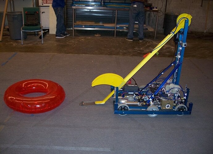

pic: 2 Weeks Without Homework

Originally Posted by ,4lex S. View Post
4lex S,
Considering where you drew your inspiration from, I am not surprised that this design turned out so beautiful! I really like this and will definitely ask my students to consider using something very similar, if the game lends it's self to this design.
Again, based on the game, I might suggest some mods, but over all, this looks extremely well thought out.

Re: pic: 2 Weeks Without Homework
Overall, very nice! Looks solid and efficient.
One quick question: How do you tension the drive chains? Sliding blocks like 254/968?
Keep up the good work!
Looks very nice! You put a lot of thought into this. It turned out very well.
Few questions.
Whats the weight?
Is that plexi-glass that the electronics are mounted on?
What type of gearbox? (Sorry, I can't really tell from the picture.)
Overall, I love it.
-Rion
I have to say I like the nice clean bumper mount rails with the cantelievered wheels. the AndyMark hex bearings make this a super simple design to build eliminating any need to turn the Hex shafts if you plan it right.
Thanks for the input and comments.
The tensioning system is very similar to that of the Universal Chassis by Team 221 LLC. Essentially the floating block is moved back and forth by a cap screw and threaded hole in the block. I can take a wireframe picture later if clarification is needed.
Few questions.
Whats the weight?
I am currently unsure of the weight, as I don't exactly trust the 42 lbs Inventor spit out. Once I am done the BOM (if I ever finish ) I should have a better estimate. The frame is pretty light compared to others I have worked on though.
The electronics are mounted on a thin plexi layered on thin aluminium sheet metal (which is not visible). The reason for this was mostly electrical isolation for the control system.
The gearboxes are modified AM Supershifters with the black covers removed, standoffs installed, and a custom long output shaft to interface with the AM performance wheels.
I have to say I like the nice clean bumper mount rails...
That was an almost direct reverse engineer of the 2009 254/968 bumper mount system. Whoever came up with that design deserves a cookie for saving West Coast Drive.
Nice CAD! Why are the gearboxes turned 90-degrees from each other?
I think he means the cim motors. And yeah I have the same question. Is it just to reverse the direction of the wheels without programming?
It may just be an oversight, or a space consideration. Looks more like an oversight; I'd say those gearboxes could go in either way, as long as the chain worked.
But it isn't to reverse the direction of the wheels without programming. He'd have one gearbox out over the bumper area with both pointing the same direction if that was the goal.
Actually. I have a different theory. If you look. One AM SS is shifted by pneumatics, the other via a servo. I think it is to show that both could be used, and the best space saving way to mount them.
Just a theory.
-Rion
EDIT: I forgot about what Mr. Anderson said, he is right, I designed a chassis with these over the summer, I did the same thing.
EDIT2: Scratch that. They are both pneumatics. I would delete this.. but I can't find how.
Woot, cool to see a more completed design than what RC and I have been talking about.
http://picasaweb.google.com/rcthekid...03106851444610
I love the use of the rivets as our team has been looking at similar designs due to lack of trained welders. Great stuff! Hope you actually get to use it this year though.
The Supershifter output shaft is not in the center. Direct-driving the center wheel, the gearboxes would have to be mounted with one forward of the other if they weren't turned. The way they're mounted in this design puts them directly opposite one another.
