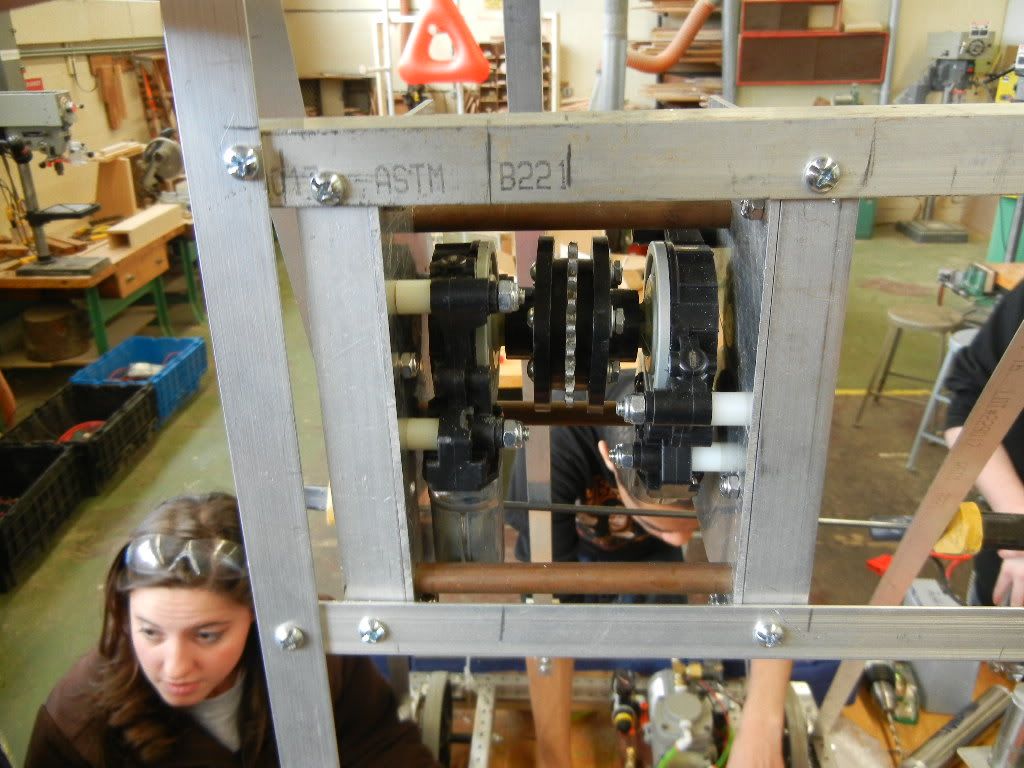

Ok...So some pictures.
In this pick the second arm segment is just stuck in. We still haven't mounted the linear bearings that will allow it to slide back and forth. We also haven't plummed or wired the piston, or mounted the cable organizers that will allow the arm to move back and forth without ripping the wires out.
This is a much better indicator of our actual progress. We may paint the base purple and the arm gold (our school colors) but I sort of doubt that that will happen before the competition. We may do it after the competition to help raise money and awareness for next year.
This shows a close up of how the arm rotation is going to work. The window washer motor is mounted below in back. The sprocket has two holes drilled and tapped to 1/4 * 20. We used the shaft from the gearbox that came with this years kit linked to the large sprocket on the other side. Some 1/2 inch inside diameter bearings complete it all so that power can be transferred from the 60 toothed gear to the arm. The gear ratio between the windshield wiper motor and the large gear is 1:2, so I'm hoping the motor will be able to turn the arm, while retaining a reasonable turning rate. If that fails, plan B is to add a second windshield wiper motor on the other side and tie the two together.

Can I ask why you chose to offset the arm to the left? Seems like an interesting design decision.

I think you should consider how you will be covering up that giant sprocket. It would probably not pass inspection for safety in it's current form.

We were thinking we would cut some lexane sheets and thin aluminum u brackets to minimize the risk of someone getting a finger caught in there. Another idea was to go get a bicycle chain cover from the recycling center and then make a bracket to mount over it. At this point it is a thought in the back of our mind...Of course the problem with covering it is that to cover it might increase the likely hood of fingers getting caught up. by creating new pinch points.
The arm and babybot launcher are offset to increase the length of the arm, and decrease the likely hood of an interaction between either of them. In its current configuration the arm will be able to reach well over 9 feet.

So the arm sort of had a melt down today. The tension on the chain is pulling the sprockets out of alignment. I came up with a fix tonight. 2 really big brackets that hold both the Denso motor and the big sprocket in alignment.
That might make it more difficult to mount the plexiglass safety shield, but we will figure something out.
