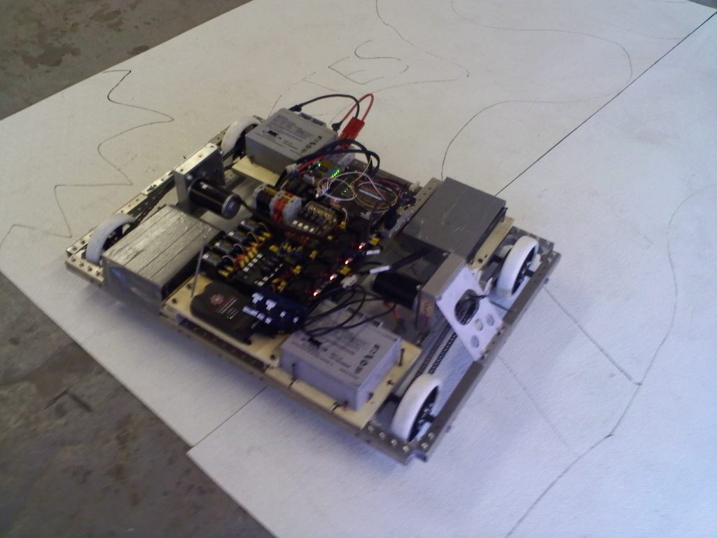

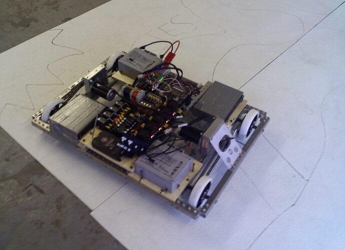

When we move the inputs we get a slight delay the robots movement. For example we move the joystick forward, and the robot moves about a second later. This might not seem like much, but it can handicap us during competition as our reaction time would be affected. Does anyone have any idea on what would be the problem.
