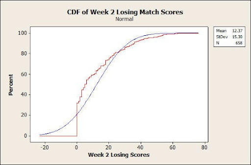

Re: pic: Points Required to Win a Week 1 Qualifying Match
Here is the lowdown for Week 2.
The average losing/tying alliance scored 12.37 points. The average winning/tying alliance scored 40.62 points. These were compiled by the same MATLAB script as the week 1 results, so in both cases it is losing/tying winning/tying. The average losing alliance scored a little over a point more than last week, the average winning alliance scored a little over 3 points more.
The highest losing score was 76 points.
