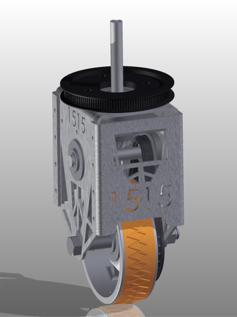

Final-Draft for the CAD! I added an extra bearing to hold the drive shaft. The sides are now riveted on, as opposed to bent from one piece. After creating a BOM, I found that 4 modules will end up costing about $750.
The entire module, from the top of the Timing-Belt pulley to the ground is exactly 7" tall. it is 2.65" wide, and 3.5" long.

You are still likely to see misalignment between the bearing holes on either side of the module that will cause grief for you in the bevel gearset.
If your team isn't yet capable of building a 4WD frame that doesn't wreck ball bearings, you should not expect to have success with a swerve drive yet. Focus on improving your deficiencies instead of replacing them with all new ones and you'll find it to be a valuable experience.
Again, this is an offseason project. It is to test whether or not we will use Swerve on the 2012 robot. It is very possible that we will put it off for a year and use it on our 2013 bot. We are simply building this to test our abilities and form a relationship with a SM shop.

It looks like a nice module. Do you have a weight?
Also, I see the gear for a belt to rotate the module, but how are you actually going to attach it to the robot?
From personal experience, that was the toughest part to get working right.

I would have doubts on the ability of the single output shaft to be able to take the side force from impacts regularly incurred in FRC competition, also how would you be taking thrust load from the weight of the robot? In general these are both really important factors for swerve drive. I would recommend looking into Delrin and other bearing systems to attach it to the robot.

Test the living daylights out of it. Weigh it down, run it hard, long (lower voltage), and against defense. Complex components have a nasty habit of seeming really great until you actually need them to be.
And, just to clarify what I think a lot of people have been saying (I think you realize it): Don't build a swerve to test if you can do it. Build it to learn the skills you need to build great drivetrains: testing, troubleshooting, consistency, accuracy, robustness. (not exhaustive) Emphasize those lessons over the result of the actual device. They're more important, for FIRST and beyond.
