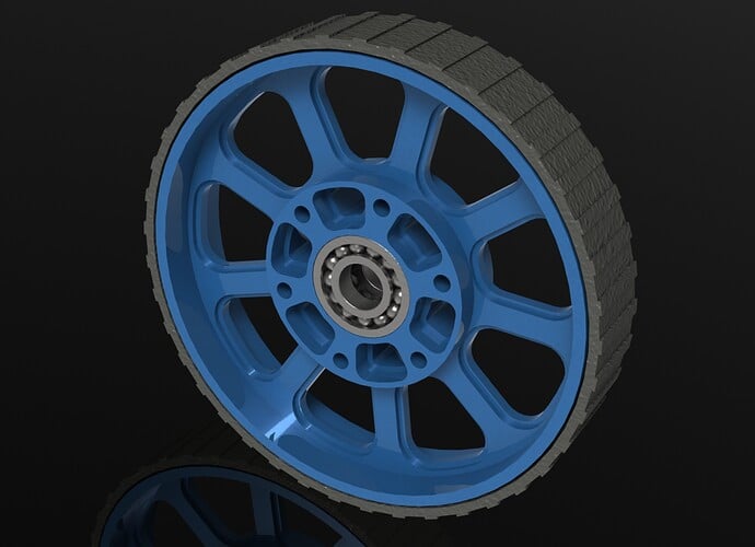

pic: Uber3.0 - prototyped
Re: pic: Uber3.0 - prototyped
That is one sweet looking frame.
Want to give us some specs? |
We completed a prototype this fall geared similarly to this, I completely see why you chose a faster speed, with a reasonable amount of practice it is very controllable and highly useful.
16 FPS single speed sounds brutal. Not enough room for error there... A 12 feet per second skid might have that.
Did you not account for frictional losses? If you didn't, then your drive is very similar to 1503's this year. |
#7
Off the gearbox I'm running 32:38 for a total ratio of about 5.55:1. The wheel well layout is inspired by 1503 but instead of 35 chain I went 25 and threw in bolt action tensioners to pull the end wheels to take up any slack. Also I decided dead shafts opposed to live. Also I'm not worried about to much speed, we enjoy going fast, plus we have the option to throw in an electronic shifter as we have in past years.
P.S. My mistake it is CIMple not cimplex. |
#8
I would not recommend trying to drive that fast without some software support. I think a simple 2 stick, or 1 stick drive setup would be quite difficult to handle. However, every driver is different, so YMMV. -Brando |
We basically just elaborated on Cheesy Drive. 2 stick drive system- 1 stick is essentially "throttle" the other stick is essentially "steering". There was a button on each stick. One button for shifting, the other button for "quick turn". Quick turn essentially turned the steering stick into a single stick drive system for turning in place. As we traveled at a faster rate of speed, the gains in the turning loop would adjust so that dumping the steering stick all the way to one side or the other would create a smooth, controlled turn. This occurred even at 16+ ft/s top speed when we traveled back and forth across the field. Additionally, even at low speeds, the robot could only turn in place using the quick turn button, otherwise it would drive in a small arc. I did not do the actual coding of it, so I'm speaking more from a theoretical/design point of view, but that's essentially what it did. Driving without this setup at top speed was quite difficult. We noticed right away as our driver began driving just the drive system in week 3 or so. He practiced driving the full field and then dipping into/out of the human player lanes over and over again. We continued to tune the system until he felt it was solid, and we were satisfied with the results. -Brando Last edited by Brandon Holley : 16-11-2011 at 14:14. |
#11
So, if I'm understanding you correctly, turning rate limits were controlled based upon the speed of the robot.
That does seem like it would make the robot easier to control. I also like the idea of a "quick turn" button too. I assume that made the robot to a very fast about-face? |
#12
Quick turn would change the control scheme to allow turning in place. If you held the button down and moved the stick left and right, you essentially created the control scheme you get from moving one stick forward and the other backward in a standard 2 stick setup. -Brando |
