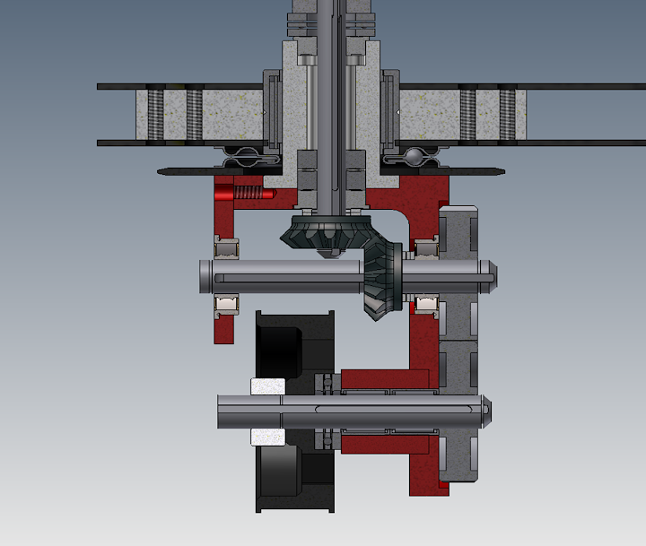

pic: I was bored... so I designed this.

Any particular reason you are cantilevering the wheels on the swerve modules? Any time a bevel gear is involved, you generally want to be as structurally rigid as possible.
Other than that, looks like a great design and a fantastic render.

Amazing design and nice render. Also, the cantilevered wheel is so that the drivetrain can perform like wcd and swerve.
Careful ... WCD takes advantage of cantilevered design by pushing the wheels out as wide as possible; it's so far that it's not possible to put pieces of the frame outside of the wheel base unless the frame is above the top of the wheels. Doing so greatly aids in stability and turning. By design, setting the wheel base width as wide as the frame is not possible with coaxial swerve. Thus, the only benefit of this design is easy swap of the wheels (and potentially reduced manufacturing time) -- which, IMO, doesn't outweigh the benefits of a boxed swerve module.
This point would only hold true if the wheel was further out in the chassis. As it sits right now, the wheel appears to be centered with the axis of rotation of the module. Odds are, the wheel was either cantilevered for weight or aesthetic purposes.

I don't want to "slam" anyone who works this hard, so please don't take this the wrong way, but I think this system has a few problems.
First, your modules. Yes, cantilevered wheels offer easier access, but they are not the end-all be-all most important drivetrain feature in FRC. The reason my team cantilevers wheels is mainly for simplicity and weight. Cantilevering wheels in a swerve drive saves negligible weight (maybe a half pound?) and makes the whole wheel and module significantly worse supported.
In 2008, team 148 built modules much like yours, but with a fully supported wheel. Even then, the modules wore through bevel gears, I'm assuming due to the modules twisting causing excessive tip loading. You'll notice teams like 1625 and 1640, two popular coaxial swerve teams, go to great lengths to make their bevel gear setup rigid. 1625 used a "puzzle piece" method of connecting 1/4" plates while 1640 uses gussets to connect a piece of U-shaped extrusion together.
It also looks like your module support is a bit lacking. It looks like you have a single thrust bearing mounted to a piece of 1/8" metal plate supporting all of the forces on the module. That's a pretty extreme cantilever. A lot of teams use a lower support for at least extreme loading, or they support their modules in multiple places / over a wide area. Think carefully how you want to do this.
Swerve drives are tricky - that's why even well funded teams with many engineers don't get them right.

Thanks for all the complements about the render and design.
I cantilevered the module just for fun and aesthetics of the module.
I have attached a section view of the module (not mounted to frame and without bolts). There may be support issues still but I did try to take into account as many of the load issues as possible.
(the image is a little squashed so it looks a little off)
About the module itself:
The main body of the module is machined out of a 3" long piece 5"x3"x1/2" Aluminum Angle. The top of the main body of the module is adapted from my teams current swerve drive module design. Also I did not want to cantilever the bevel gear so I went ahead and supported the bevel gear shaft on both ends. (This module was designed just for fun really so there may be issues I am unaware of). I welcome any advice and comments about the design.
