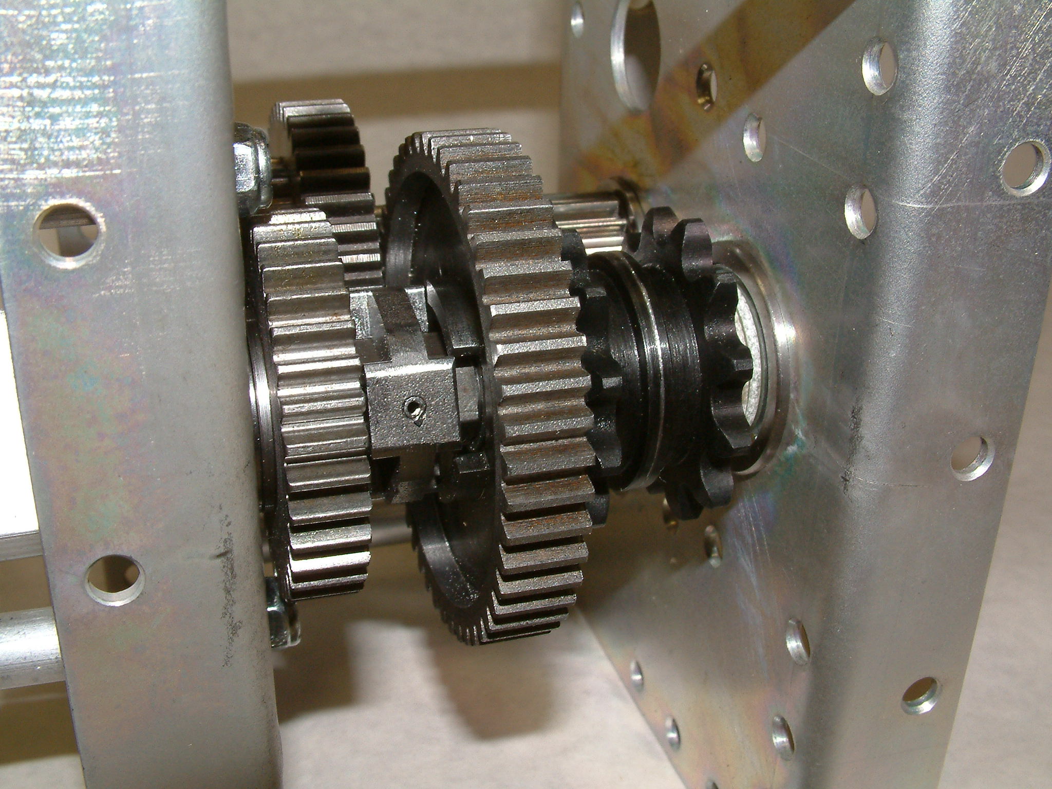

AndyMark shifter Dog Gear screw problem - lower your pressures
All,
This past weekend, we were informed of an issue by three different customers. The M2.5 screw within the 2010-2011 AM Shifter and Super Shifters are breaking at a rate higher than expected.
The initial fix for this is for teams to lower their shifting pressure from 60 psi down to 35 or 40 psi. Many teams already run at this lower pressure, to reduce wear on the shifting parts.
During the years of 2005-2009, we used a 3/32" coiled roll pin (heavy duty) to attach the dog gear to the shifter shaft. This past summer, we replaced this roll pin with a M2.5x20mm hardened screw. While our break tests proved that the same amount of force broke both types of pins, it seems that the screw does not handle fatigue as much as the roll pin.
The simple fix for this is to run your shifter at a lower pressure. A 3/32" hole can be added to the dog gear, in order to accommodate a 3/32" roll pin, if you wish to add this pin.
We will be doing some more testing on this, determining what exactly is going on. I just wanted to let folks know that this is going on, and they may want to lower their shifting pressure.
Keep in mind that the shifter shaft position should still be set up so that the small brass "pin saver" tube is in place so that the dog gear does not bottom out on either the full low or full high end of the cylinder stroke.
Once we know more about this, I will post the info.

We found that running about 14 competition level matches breaks the screws. It happened to our practice bot at home, and then again at Lone Star. Our solution so far is to replace the screws (M2.5 x 20, McM# 91290A108) every three competition rounds and running at 45 psi.
Edit: The only thing is the shifters shift a lot more sluggishly at 45 psi.

I posted the McMaster number for a similar replacement part, it's 20mm long, and they're physically the same as the AM ones.
Edit: It is a lot easier to replace the bolt before it has sheared than after. After it shears, it usually breaks off leaving the threading in the dog gear. For replacing the bolt, you just need to rotate it so the bolt faces somewhere you can put an allen key in (down for us.) It is literally a 2 minute job to replace the bolts versus a 30 minute swap of dog gear if it does shear.

To allow the shifter to work more smoothly and reliably at lower pressures (and just in general):
What I have always found with the AM shifters is that you need to leave the cylinder somewhat loose/floating in the mounting. In other words, do not completely tighten the nut holding the cylinder to the mounting plate. What this does is allow the cylinder to easily adjust to any slight misaligment of the dog shifting shaft and the cylinder and mounting holes.
Use threadlocking lock-tite to hold the nut in place. Tighten the nut all the way and then back off about a 1/4 turn to allow everything to float and align itself how it wants.
To fix the screw breakage problem more reliably (especially if you do not want to reduce the pressure):
Do not just replace the M2.5 screw with another screw. The threads on the screws inherently act as a stress concentrator. Instead, drill out the one side that is threaded with a 3/32 drill (use Anchor Lube to make this easy) and press in a roll pin.
Hope this helps.

Yes, the screw is a M2.5 x 20 socket head cap screw.
Thanks! We'll check it when we un-crate the robot in St. Louis.
